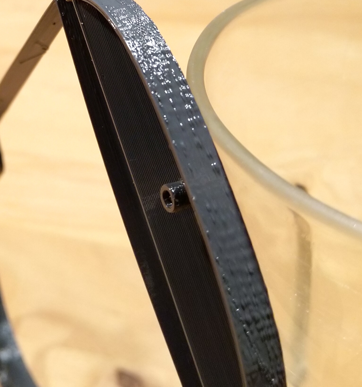

I'm experimenting with thin wall parts on my Sidewinder X1. Normally I would prefer using Simplify3D over Cura oder Slic3r for those parts. Now I'm facing with a strange stop and go in printing speed on my Artillery Sidewinder X1. Also the the prints are very bad. Very interersting is the fact that the first layer doesn't suffer from this issue, but from the second layer starts the pain.

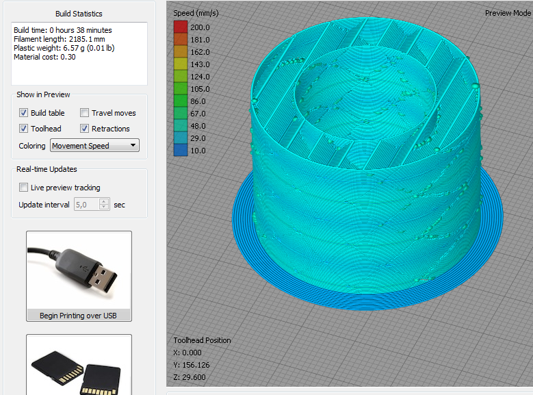

Posts: 852
Re: Strange printing speed with Simplify3D
Thu Nov 21, 2019 3:02 am
Hi Buckker,
I'm sorry, but I can't see what the problem is with your code.
The speed, is it to fast or is it to slow???
The print preview looks ok for me, all speeds are in a range, resulting by your settings (Preview > Moving Speeds)
If the F-value is the point, please note that GCode transforms the mm/s - settings back to mm / min. Your travel speed of 200 mm/s will be translated to 200 x 60 = 12000 mm/min.
The printing speed may be manipulated by the settings of Speed Overwrites.

The main issue is that the printer has a stop & go behavior while printing the outer perimeter during the mode "allow single extrusion walls". I think simplify calculate a wrong amount of material. As a result of this are the artifacts on the outer shell.
some print parameters could be wrong. I accidentally delete some of my profiles and had the create them new (but they aren't tested yet).
