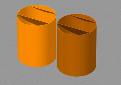

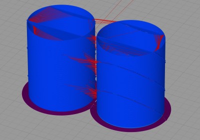

BTW, i found out that the way how a CAD model is created and translated to a stl has a big impact to my problem. Those parts looks the same, but the way how I created them is different. Seems to be a problem in some cases...
