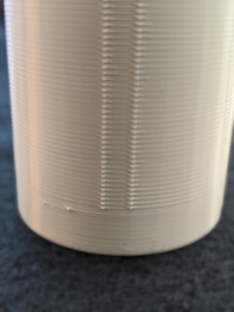

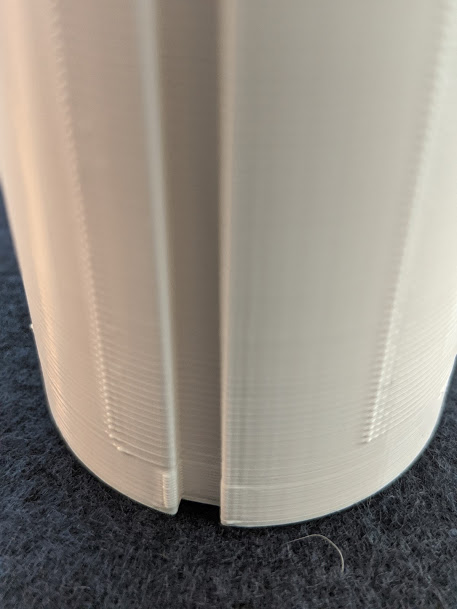

The lines in my prints are getting worse and I'm too ignorant about the inner working of 3D Printing/Slicers to be able to figure out why... CR-10S with an E3D V6 Hotend.
As I was typing this and looking again at the issue I may have realized something about the shifting of the line. You can see that the line shifts to the left about 25 layers up. I figure that's about 25 layers because I printed at 0.2mm and when I measure that distance it's about 50mm up before shifting.

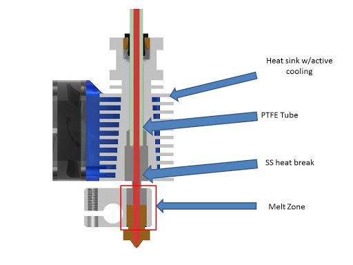

When I first got my V6 Hotend I had a lot of trouble getting any good prints. I had the dual fans running at 100% and it's obvious why prints weren't good. Now I run the fans at 0% for the first 24 layers, see where I'm going with this, and then at layer 25 the dual fans come on at 25%. Those are the only fan states that I use.
Could the fans starting up "push" the line to the left? A better question is how do I eliminate the lines altogether?

Are you talking about the massive "blobby" retracts when cooling kicks in?

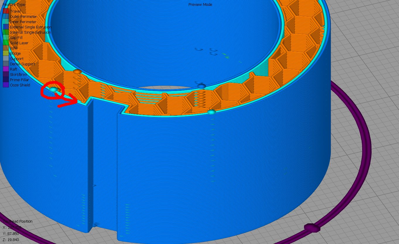

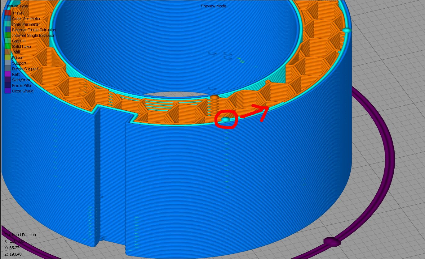

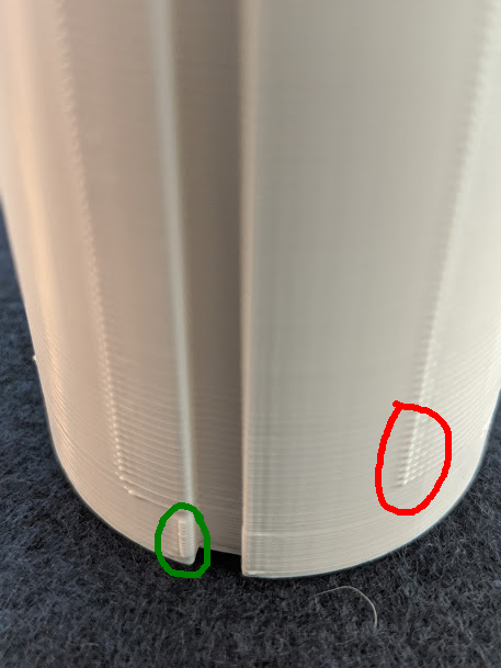

Green ones look okay, red ones don't. That is if there's the retracts, hard to say without factory/gcode file. Print speeds are the same all the way through the print?
If cooling on/off is the only difference:
Make sure the fans are not blowing at the heater block, a silicone sock won't fix that problem. In combination with wrong PID tuning that will
make your hotend heat much more than the thermistor might report....
Not very likely...
Check at what point this happens. If this happens after retracts then there's probably too much material left which
then gets "smeared" along the perimeter, giving the ripple effect. Check options like retract on layer change and so on...

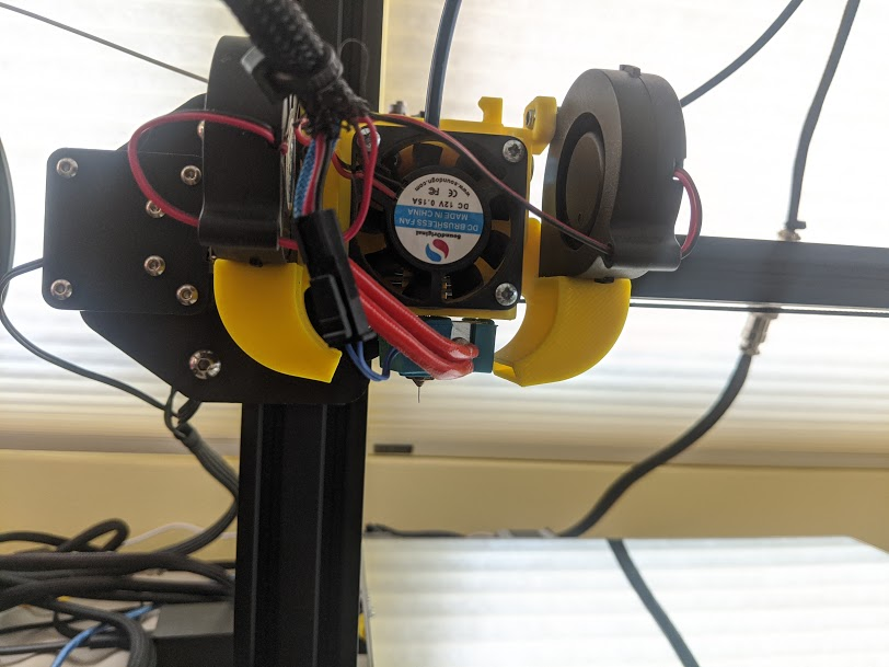

fatboy1271 wrote: Fri Jul 24, 2020 6:19 pm E3D V6 - Fans.png
btw, the fan on your hotend is mounted the wrong way. It's sucking air away from the cold zone which usually doesn't work as well as pushing the air through the fins (and as recommended by e3d).
Fixed! I looked at the V6 assembly instructions and saw what you mean. Good eye and thanks!!!

This is a long post, so I first want to start off with a big Thank You!!! I greatly appreciate when people take time out of their day to help others!
parallyze wrote: Sat Jul 25, 2020 8:57 am Are you talking about the massive "blobby" retracts when cooling kicks in?
Yes!
parallyze wrote: Sat Jul 25, 2020 8:57 amGreen ones look okay, red ones don't. That is if there's the retracts, hard to say without factory/gcode file. Print speeds are the same all the way through the print?
What you marked in red is when the fans kick in.
Factory file is attached, but Gcode is too big to attach here, so I've shared in from my Google Drive: https://drive.google.com/file/d/1hLPeeM ... sp=sharing
Yes, print speeds never change.

it's really hard to recommend something without seeing the device "doing it's job"... :D
Had a look at the factory file - and I just have to ask: Why are there so many processes? Do you manage your print settings this way instead of using profiles? It's a bit confusing... :D
Anyways, looking at the slicing preview (I chose the 0.20 process) retracts seem to be located where your prints are showing problems.
There's a few things to watch out for when retracts occur, especially if using a custom mounted hotend.
1. There's two versions of the e3d v6 - the "none metal" and the "all metal" one. Sometimes people get confused by this and don't put in the PTFE tube inside the all metal one. There's PTFE tubing in both of them. Inside the regular one the PTFE goes all the way down into the nozzle, inside the all metal version it ends at the throat/heat break inside the cold zone:
It's extremely important there's no play up/down when everything is mounted. Also the bowden fittings on top should have no play. If the PTFE tube is missing the filament will have too much play inside the cold zone, getting nice retracts will be very hard then... ^^
If everything is mounted the correct way I'd think you should try retraction distances of ~1.2mm - 1.8mm using a bowden setup. 5mm sounds too much on a e3d v6. If you have a look at the picture you'll notice that you're starting to pull the filament right out of the melt zone. This might lenghten the filament when pulling it out on a retract and reaching the cold zone, leading to deviations when "un-retracting" again.
Using a negative "restart distance" might be another workaround for this.
Just saw your post about the fan: Good! This is probably not relevant for the problem you're seeing right now. But bad cooling can lead to "heat creeping" and will sometimes only show up on prints with very low flowrates (low layer heights, thin extrusion widths, slow speeds) and materials with low melting points (PLA).
Good luck :)

Looking at your pictures and the factory file/gcode(which I don't have access to, but doesn't really matter) this is why I assume there's something wrong with your retract settings:
The "blobs" seem to appear each time when your printer starts after a retract on the inner walls. You absolutely shouldn't see this on the outside later. Hence my suspicion there's way too much material coming out of the nozzle... ^^

I have an All Metal V6 and outside of the fan on the Heatsink facing the wrong way, I feel like I was pretty meticulous in following the instructions. For what it's worth I replaced the stock Heatbreak, I snapped the original, with a 'Titanium V6 heatbreak V2.3 by 3D passion' and I also use Capricorn PTFE.

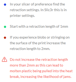

Attached is a screenshot, but it says start at 1mm and don't go more than 2mm. At least I wasn't getting any jams from the 5mm setting.
Had a look at the heatbreak. Looks like it should fit, the shoulder is clearly visible so it's hopefully not another "ptfe all the way through" clone with wrong pictures... :D
