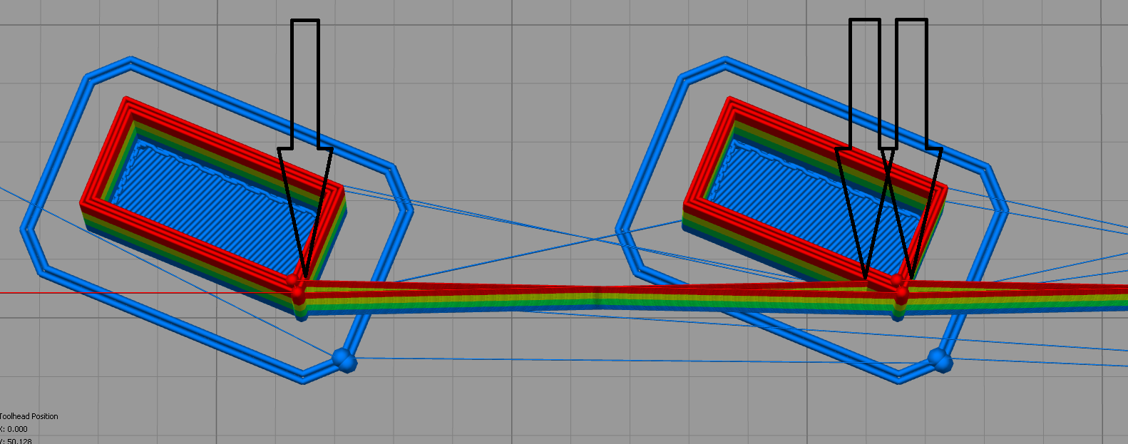

When looking for problems with retracts I'd use something like this:
3 simple boxes (20mm x 10mm x 20mm). Each one rotated at 22.5° to make sure the travel paths later on will go across
perimeters not only at the points where retracts happen (start and end of a layer/island):
www.aunix.de/tmp/s3d/s3d_retracts_1.jpg
I chose 3 perimeters and no infill / top layers. Don't really need them to check retracts, we can save some material and time here:

This is what it looks like with all the travel paths shown.
www.aunix.de/tmp/s3d/s3d_retracts_4.jpg
Now select "Preview by Line" inside the preview and check how the toolhead moves:
www.aunix.de/tmp/s3d/S3D_Retracts_Preview_1.mp4
As you can see it will do the same moves all over again. Start at the inner perimeter, print 3 perimeters, retract and move on to the next one.

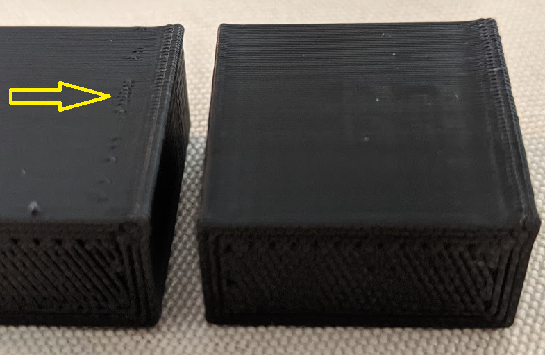

Looking closer at the print you can see the first process using 0.3mm oozes some material which gets stuck to the outside walls
when travelling between the boxes. Also the skirts aren't really good, there's material missing/stuck in places where it doesn't belong:
www.aunix.de/tmp/s3d/IMG_1369.jpg
Process 2/0.6mm is starting to look better, but still there's some spots of material left on the outside walls. With 0.9mm they're gone.
And while it doesn't change on the outside any longer there's a difference at the start point/inner wall:
www.aunix.de/tmp/s3d/IMG_1409.jpg

There's clearly some material missing - this is at 1.2mm retract distance, a bit too much for this direct drive/e3d v6 one.
This doesn't really give you values you can use because of all the differences, but maybe it can give you an idea of how to

1.8mm showed just a little bit of extra material where the cross travels for the interior layers are. 2.1mm eliminated the extra material:

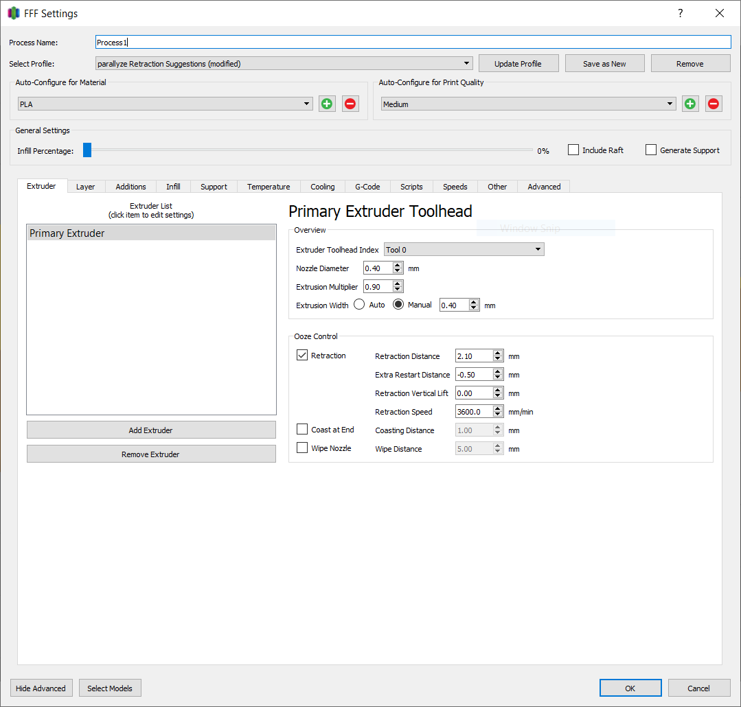

Using 2.1mm Retraction Distance and a -0.2mm Extra Restart Distance didn't seem to make much difference. I'm running another set at -0.5mm.

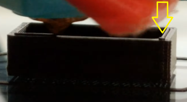

Here's a video I took; is it helpful? https://youtu.be/Z1rW5HKu7oU

Hmm... still a "blob" when starting the layer. If you watch closely you can see that the additional material at the start is missing the first few cm on the inner perimeter. It takes a while until it "thickens" up again to the proper width and it's not bonded to the middle perimeter there. So the total amount of material doesn't seem to be off by much, there must be something else...

Look at the video...and stop it at 6 seconds.
Look at that whopping great blob at the start of the extrusion. What you can't see is a similar blob at the start of extrusion of the second perimeter....and again at the start of the third perimeter - which is what you have an issue with!
So, now knowing which end, you now need to adjust the right settings to reduce the plastic flow Are you retracting? If so, are you then using Extra-restart? Are you using coasting as well, as that may have an effect on over extrusion at the start.
My first change would be to remove any extra restart. If that has no effect, dial in some negative extra restart.
Read again the section I referred you to and you shoukd be able to visualise what is happening...and you 'll then be able to work out what changes are needed to stop the over-extrusion ( or blob).

dkightley wrote: Fri Aug 14, 2020 1:18 pm Look at the video...and stop it at 6 seconds.
This guy?
dkightley wrote: Fri Aug 14, 2020 1:18 pm So, now knowing which end, you now need to adjust the right settings to reduce the plastic flow Are you retracting? If so, are you then using Extra-restart? Are you using coasting as well, as that may have an effect on over extrusion at the start.
Here are the last settings I used in Extruder. Retraction Distance = 2.10mm and Extra Restart Distance = -0.50mm, I also tried -0.20mm and didn't see anything noticeable. No Retraction Vertical Lift, Coast, or Wipe. I still have the Tips page open in a Tab, so I'll go back and look through that again.

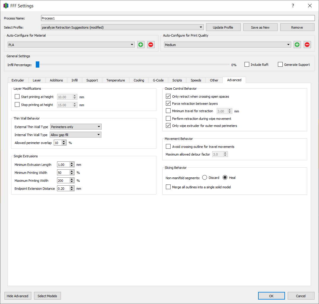

Should "Force retraction between layers" be checked or not?
