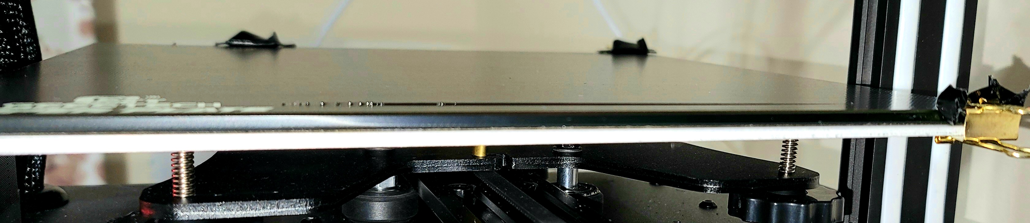

Image of failed purge line also attached (thicker line on left and thinner on right as nozzle goes into bed without utilizing mesh to compensate)
