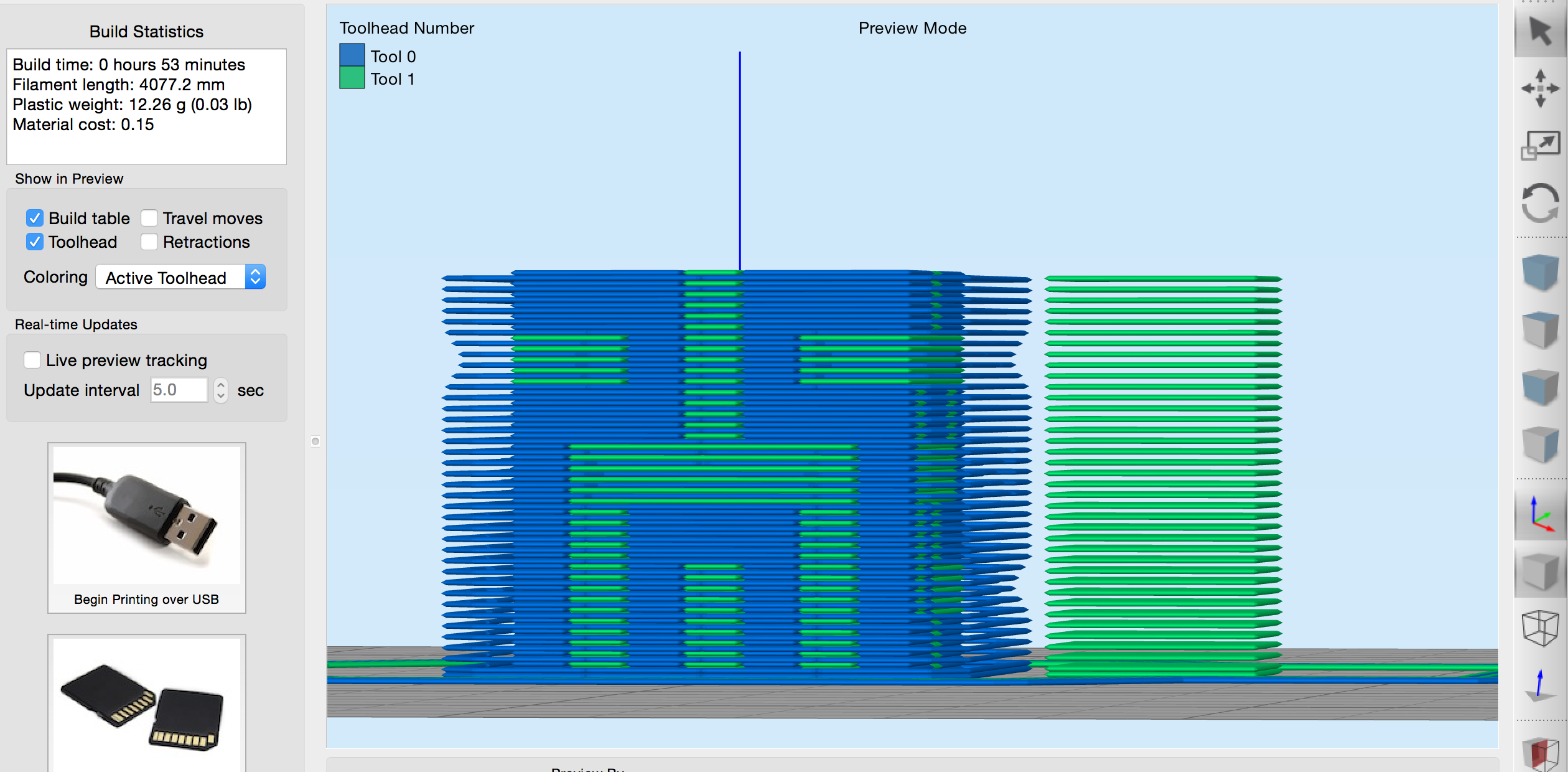

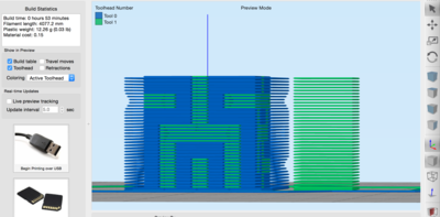

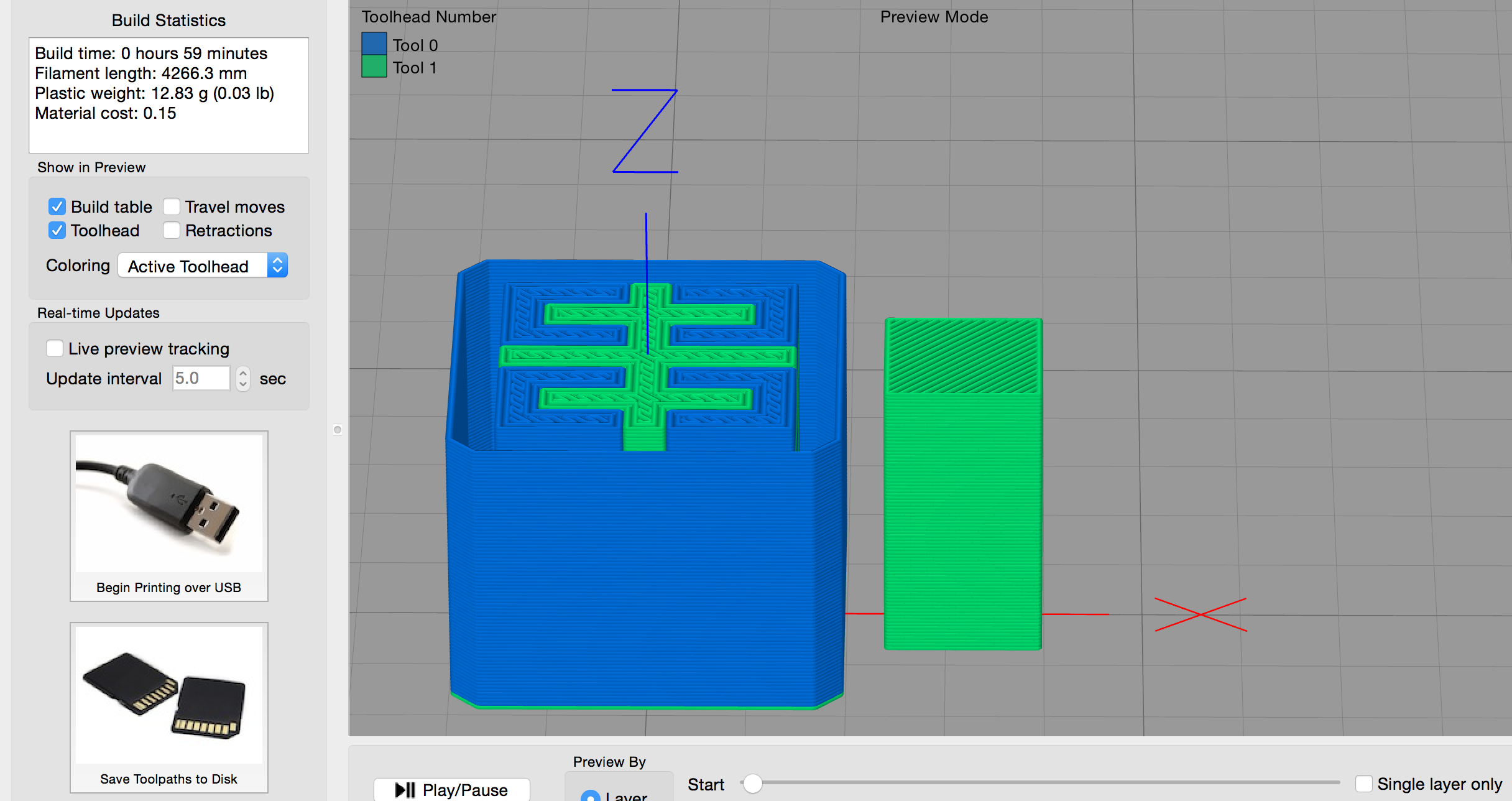

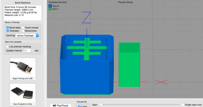

Trax wrote:I have messed around a bit trying to fix things, here is my factory file for the object as it is now.
The Skirt settings were set a bit off and didn't match each-other in the grouped processes. Using the factory file I attached the slicing looked much better. Instead of using Skirt, I recommend using Ooze Shield for the print, the prime-pillar might not be necessary as well. Using the G-Code previewer, you can see there were gaps in the first one, but not the second picture.
Current Factory File

Revised Factory File
