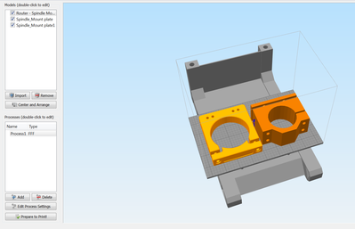

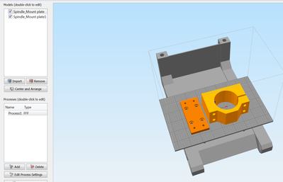

here's an example i am currently printing, each of these is after pressing "center and arrange" with different STL deselected/deleted.

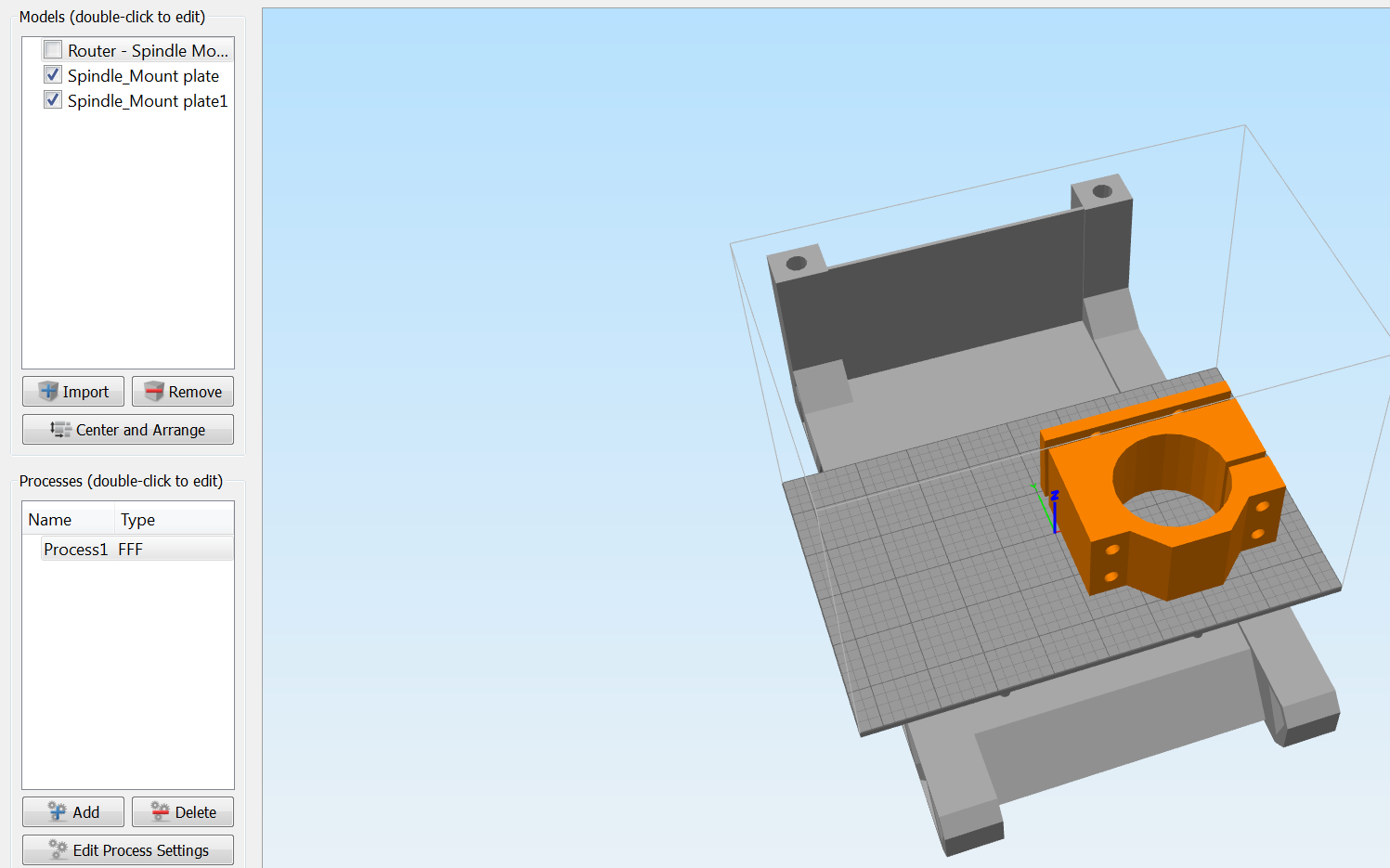

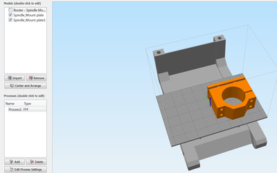

and here is what it looks like with it deleted vs deselected.
