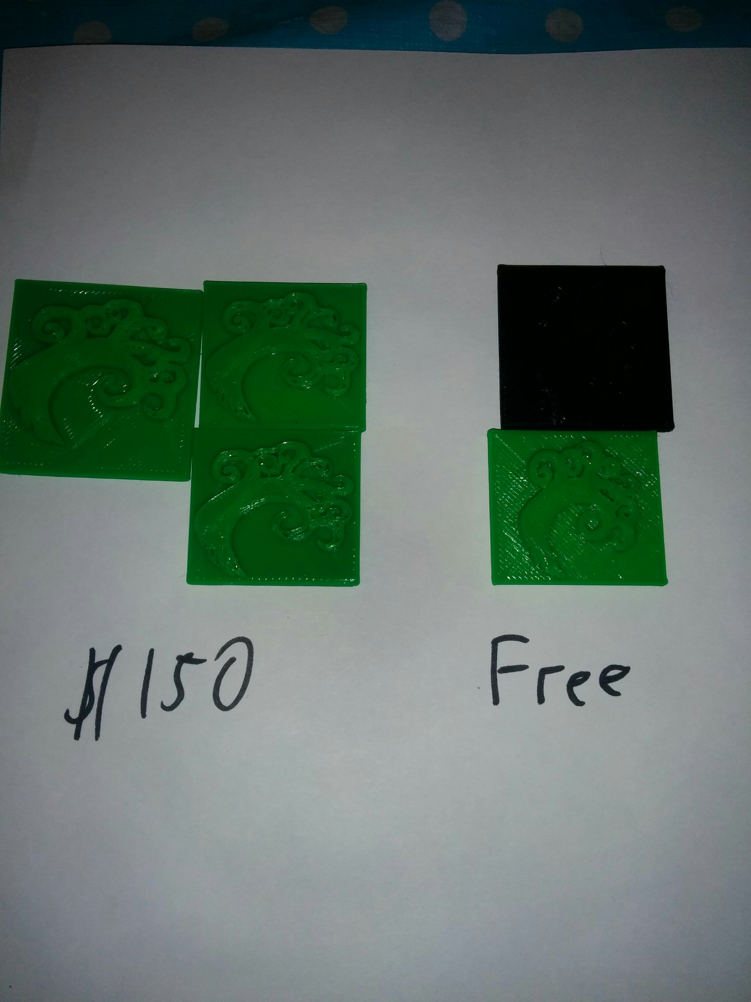

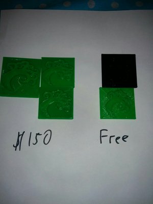

I've been trying to print out this stupid little piece for the past two days on S3D.
WavyTree.factory
(50.18 KiB) Downloaded 620 times
No matter how I turn the many knobs, increasing infill %, adding top layers, going slow, etc., I keep getting crappy prints with ugly holes in the top layer.
Earlier today, I decided to print on the free software that comes with my printer (MatterControl). Lo and behold, it prints MUCH better than S3D - it has no huge holes in the top.
WavyTree.factory
Needless to say, I'm fairly miffed. I should be getting much better quality for the price I paid. What the heck is going wrong? I'm going to need a fix on this soon, because right now I'm not sure I would recommend S3D to anyone else.

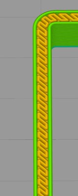

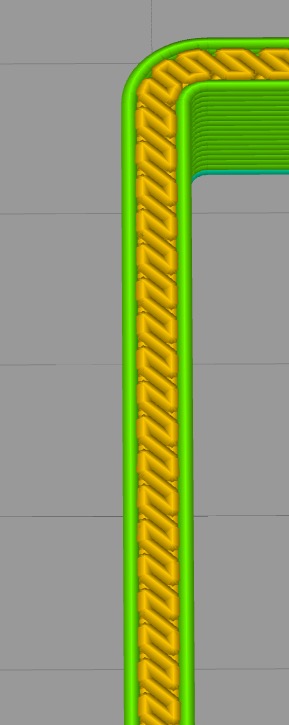

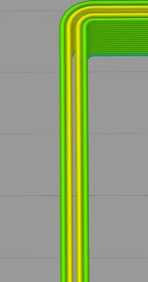

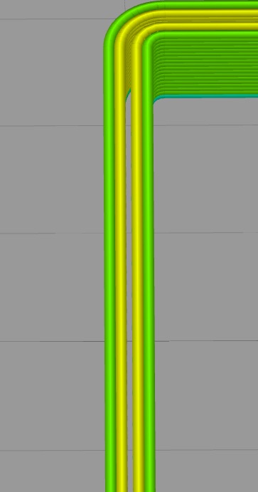

I am fairly certain that the perimeters change is what did the trick. This is something I deal with all the time.
Here are some snapshots showing a wall with 2 perimeters yet you can see down between them. Then the other image shows what happens when you set 1 perimeter, the infill takes over and fills it solid.
