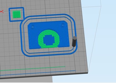

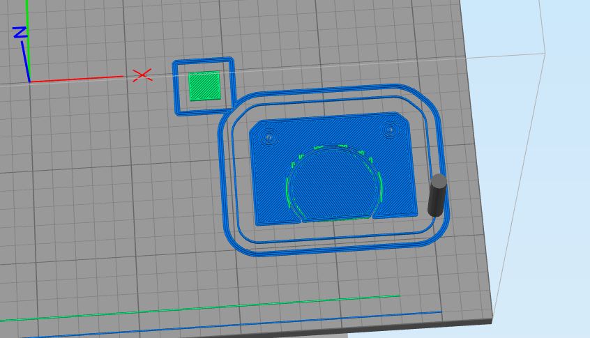

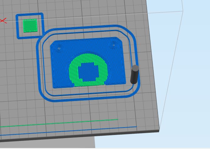

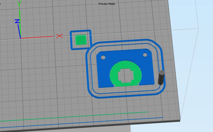

So I have seen this on two recent prints that use support, and have a 'circle', or 'hole' in the part.
It will after a few layers print a solid circle a few mm smaller that the hole, or circle in the part... Please see the images:
This one shows the support starting:
This one shows the random solid layer:
This one shows the support continuing on top of that random solid layer:

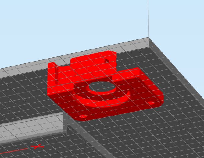

Here is the part, please note that there is no solid floating circle in the middle:

There's an issue in S3D where occasionally inconsistencies in the mesh are not interpreted correctly....and I think your model is one of the models that suffer from this.
An easy fix.....change the layer thickness in your profile by 0.0001 and try the slicing again.
The proper fix.....run the model through the online repair service: https://netfabb.azurewebsites.net/
