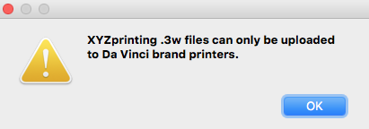

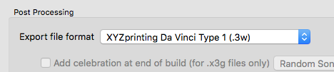

When printing, a message appears informing that DaVinci requires .3w file format, and won't print.
So, I see a file format input field in the Scripts tab of the process panel. I select gcode, then update the process and can print and/or export gcode - that part works. I also exported the process and factory file.
The BUG, is after exiting s3d, that file format field changes back to .3w. So, every time I want to print after exiting, I have to repeat this...

I've used repetier on mine as well. Just remove all of the post-processing commands since you don't need them with repetier. Then you can choose gcode for the file format and it will stay that way.

There is/was only one post-script: {PREPEND "; total_filament = [total_filament_used]\n"} .
After deleting it, it worked as you indicated.

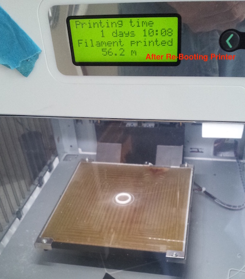

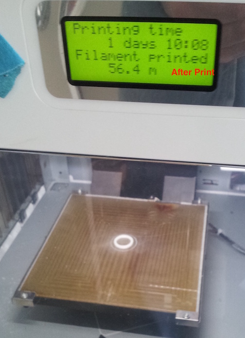

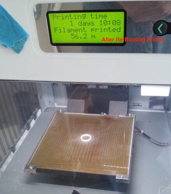

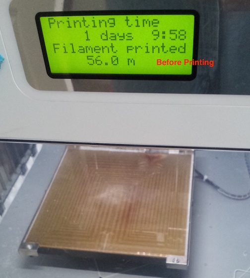

Build stats indicate job will use 0.23m
Before printing: LCD displays current amount of FF printed = 56.0m (attached)
After print completed, LCD displays amount printed = 56.4m (attached)
After printer re-boot, LCD displays amount printed = 56.2m (attached)
Limit of three file attachment so, if you do want the process fff, I'll add it to follow-up post. But, these images pretty well explain it...

You're using the repetier firmware, so you might need to look and verify what exactly it uses to determine the filament usage for each file. Is it calculated from the actual printing moves in the gcode or are they using something else? Perhaps they are actually using the filament tag (which seems silly since the firmware is already tracking the extruder movements internally and would already know exactly how much was used)

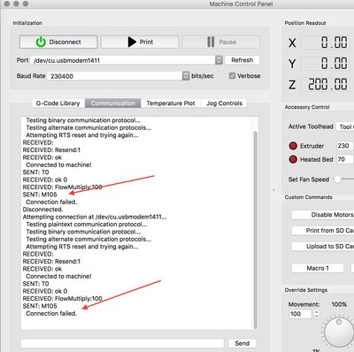

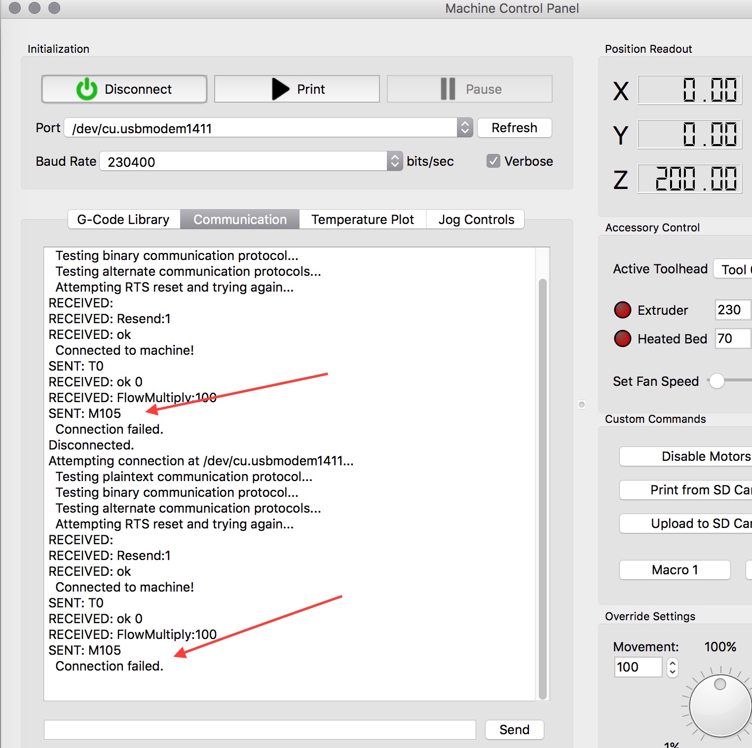

I have a setup exactly like yours, and I saw the same error message as you.. however, after upgrade, I cannot connect to my printer any longer (see pic).. I've tried the checkbox for 'accept M101 commands' under g-code, but still the same thing.. I have tried to go back to 3.02, but the same thing again. Never had this problem before... any ideas?
and I agree, $150 for this software, and after update, I can't use it any longer :/ NOT cool.

There's nothing that would be different if you go back to version 3.0.2 unless you changed your profile. So if you want to use 3.0.2, you might also want to go back to Help > Configuration Assistant, and make sure you download a new fresh profile for the 1.0.
Something that also helped me was going to Tools > Firmware Configuration, clicking on the Communication tab, and enabling hardware flow control. After you do this, you may need to click Export at the top to save a new configuration (more info about why that is needed here: https://www.youtube.com/watch?v=NYPUAqT4UyI)

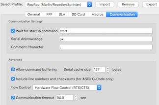

I had dropout problems in version 2.x but resolved it by changing the control flow, cache, timeout...
The settings in attached are those that have continued to work for me...
