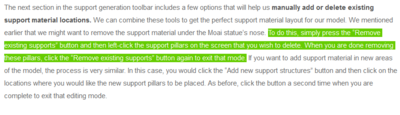

I am referring to this tutorial https://www.simplify3d.com/support/tuto ... tructures/. I don't see anywhere in it's instructions that alludes to or indicates that removed support structures will be generated anyway which is in fact what is happening. It seems to say just the opposite.
To be clear, there is a different between "I removed some supports" and "I removed all of the supports for my entire model". As it says, if you enable support generation, it's going to make sure that there is SOME support for the model. The only way to stop that is to either add your own supports manually or disable support generation all together. So if you are trying to stop support from being added, then just disable support generation.
