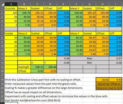

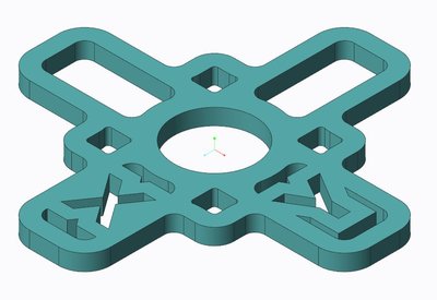

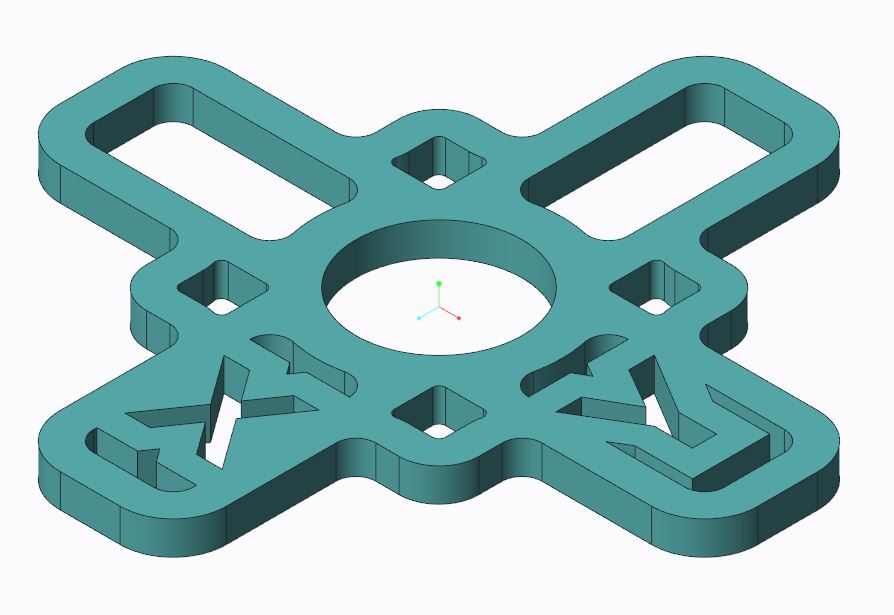

I designed a 'Calibration Cross" that I use which includes large and small dimensions with both inside and outside measurements. I print one of these parts scaled to 100% with no horizontal offset. I then measure the printed part and use the attached spreadsheet to dial in my numbers for X & Y scale factors and horizontal offset.
See next reply for STL file and zipped EXCEL file.

Make sure you part has cooled to room temperature before taking measurements. If the part is still warm it will skew your results.
First I find the horizontal offset that gives me closes to 10 in the boxes in the lower right.
Then I adjust the scaling factors to get the numbers in the blue DIFF columns as close to zero as possible. Some will be a little above and some a little below, but in general I can get everything within less than .1mm of nominal - usually half that.
Anytime I make a significant change in my print settings I will run off one of these crosses and figure up new scale and offset factors to guarantee a print that is as close as possible to the nominal dimensions.

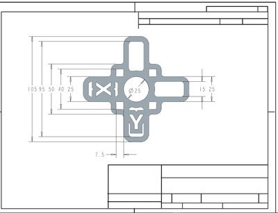

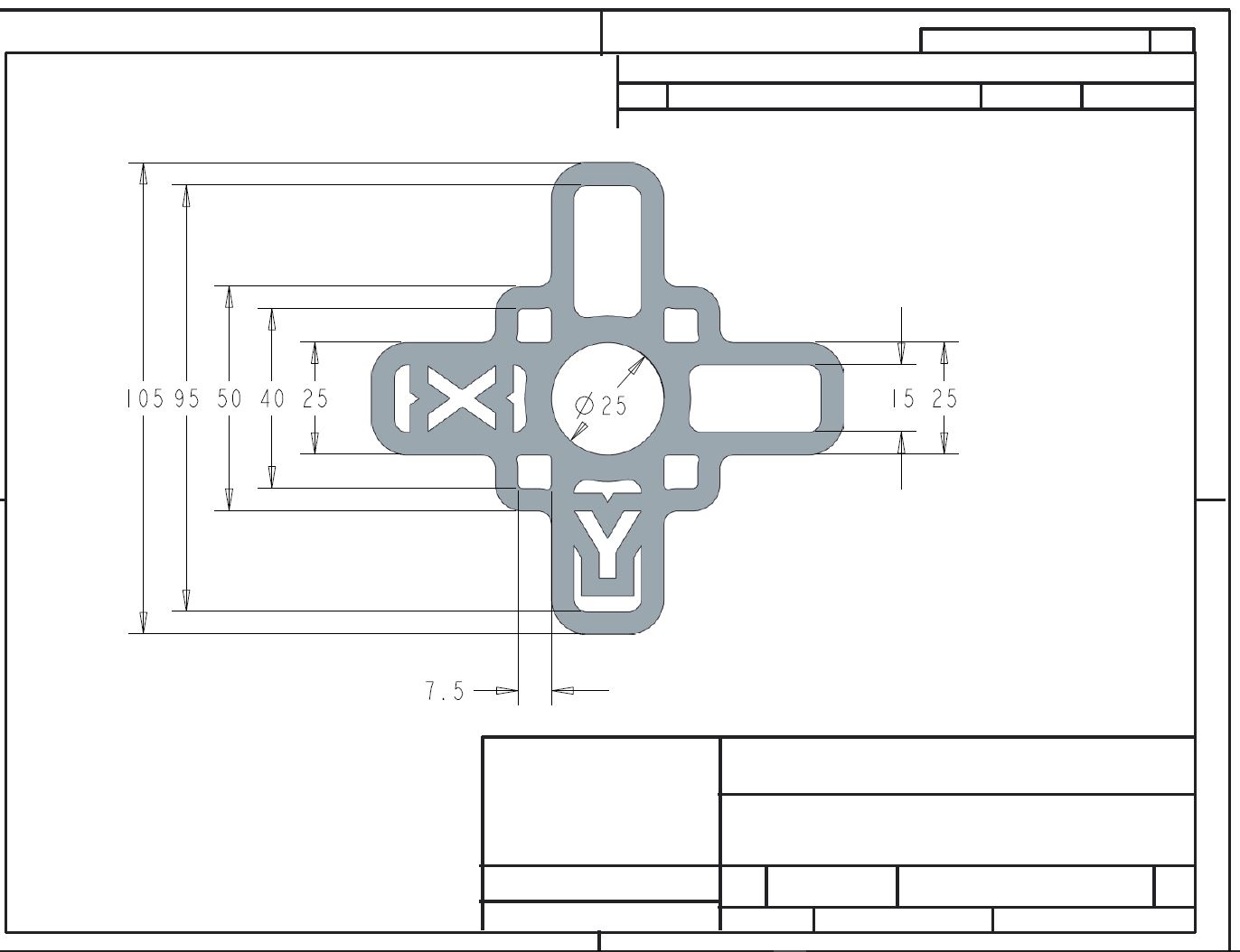

I've added a few useful fields to the spreadsheet, and also added a Z-Axis calibration. I have attached an updated drawing, the latest spreadsheet, and the STL file for the Z-Axis scaling.
