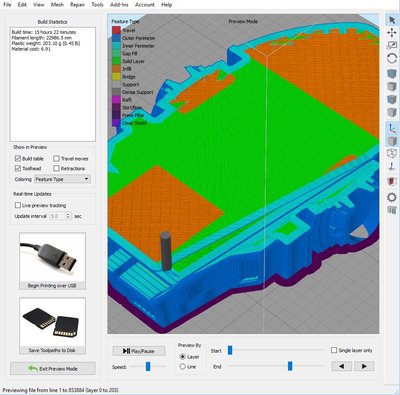

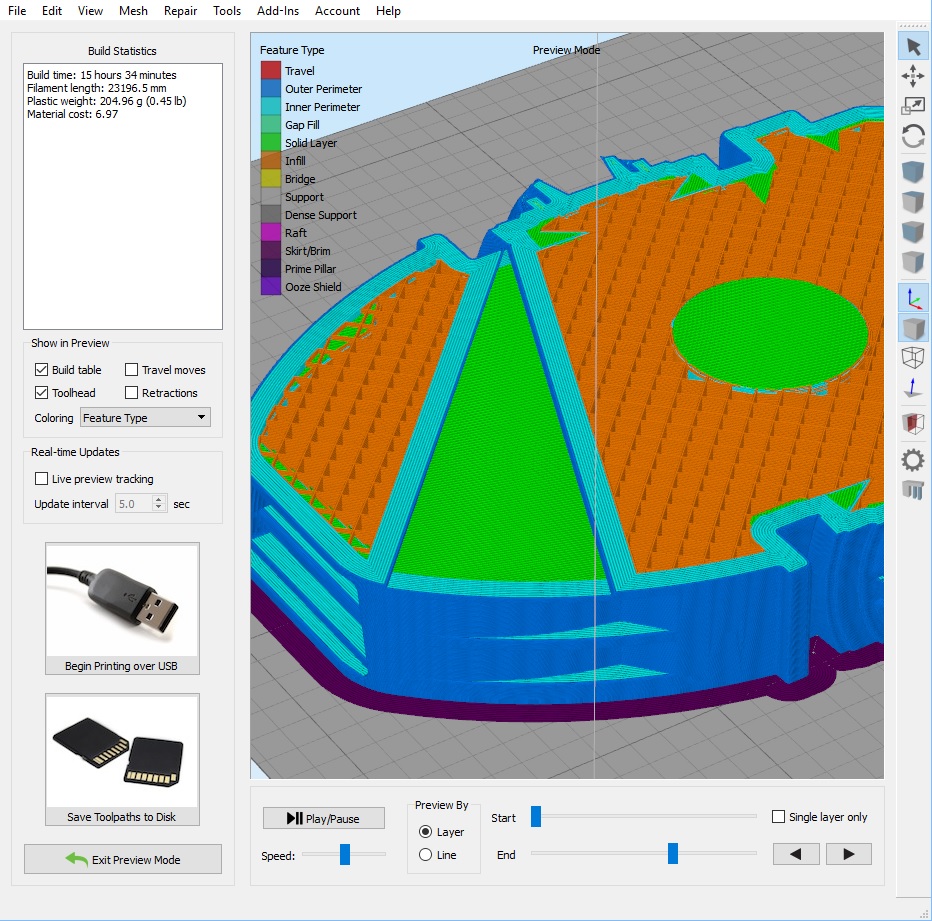

I have a strange thing happening with this part.
when I have it at 90 degree angle i gap appears mid layer.
If I orientate it at -90 degree a different issue occurse.
it occures from layer 198
can someone please help me out on this
cheers
issue at -90 deg orientaiton

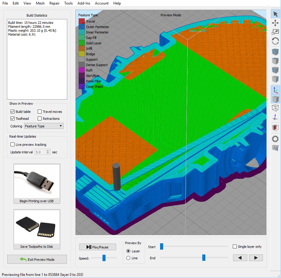

had to add another post for additional image
this is when I have it orientated at 90 deg
Issue at 90 deg orientation
Re: weired slicing behaviour
It looks very much like errors in the mesh....
Have you run this model through one of the repair services?? The Netfabb service now seems to have stopped playing ball with .stl format files...try:
