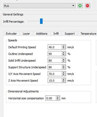

A. Set the speeds. visualy you see how fast its printing the plastik, on the image attached first box is set to 40mm/s, tisnt that fast when you've had succesfull 120mm/s print speeds,
well every now and then it'll print at some very very fast rate for no reason. i.e. it's motering like whore on crack...like no way is it doing 40mm/s, its more like 80-90 mm/s...and then the next print will print at the narmal speeds.(40mm/s or less acourding to the percentages set in the other box's on the attached images).

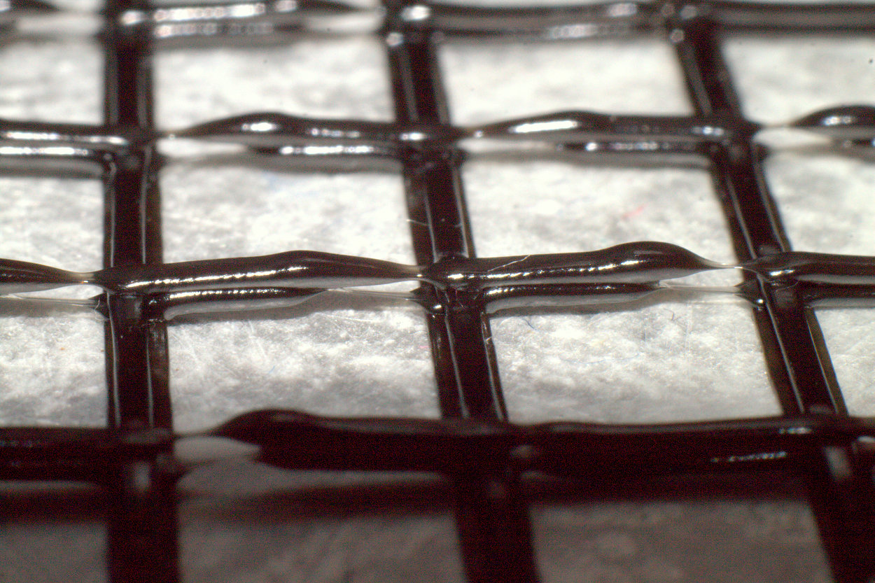

C.the infill pattern has the angle set box to set the grid up, a posative and negative number added there gives a criss cross pattern infill which prints one layer in one direction, and the next lay in the other direction, or you tick and have a full criss cross on every layer, well the neegative i.e. -45 degree infill layer scips and does not exstrude continualy...image attached, that's two layers of missing bits 2 of full lined exstrution in the image.
however the other layer (the posative degree i.e. 45degrees extrudes continualy as it should).

I'm not sure this is an issue with S3D...more like an issue with your printer. You will need to present some evidence of the slicer generating the wrong speeds in the gcode before any investigation can be made.

The extrusion for both of the directions for infill is a continuous move from one side of the infill area to the other. Your photo seems to show an issue with the flow rate through your nozzle....not an issue with the gcode created by the slicer. This may be due to the temperature being too high or too low, or the speed being too slow or too fast.
