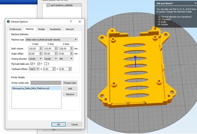

This shows settings with an object that should be too big to print.
Printer Settings with an object that should not fit

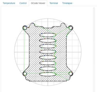

My octoprint gcode viewer showing that it is indeed to large.
GCode view in octopi showing correct area

The X and Y size should be for the square plate that would fit inside your circular bed, not the diameter of the circle. So if you have a 110mm bed, then the X and Y size should be 0.707*110 = 77.77.
So set X and Y to 77.77 and then it will work correctly
