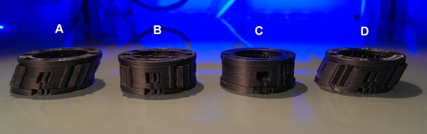

I ran a another large series of tests. Full test details are below.
However, let me summarize the results first:
Something about the way that S3D defines retractions appears to cause corruption of the axis position in the Leapfrog. The amount of corruption I have to assume depends of the length of the rapids after the retraction which depends on the geometry of the part and how it gets sliced.
I know that sounds like the printer is losing steps due to speed. But the last test I did last night was printed VERY slow, only 15mm /sec (900 mm/ min). The print that typically takes 40 minutes took over two hours each to print. No way it's losing steps due to speed when its running that slow.
I know very little about gcode, and the way that S3D does retraction certainly seems logical. However both Kisslicer and Slic3r use a different syntax. So is it an S3D bug or a Leapfrog bug?? No idea, let the finger pointing begin :-)
Now I said that I would modify my part and post it. I changed my mind. (Not worth the risk to my day job.) I did modify the part for these tests, but I don't feel it would be in my best interest to post the part in the open. However, if you are actually interested in trying the test send me a private message with your email address and I will send you the gocde, STL, and a factory file of the modified part to try. I did however post the headers from S3D and Kisslicer below.
So here are the the test details:
Part A:
Default Creatr Dual (Right) profile with the following changes:
Infill 40%
Support 2.4 mm
Bed 60C
First layer 205C
Third layer 195C
Cooling 60% starting at the third layer (my nozzle cooler)
Result = Extreme Skewing
Part B:
This was run immediately after Part A. The only change was that retraction was turned off.
Result = Part is okay.
Part C:
Also run immediately after Part B.
Part sliced with Kisslicer and printed using Repetier Host.
Part D:
I did this to check if perhaps the power supply was drooping somehow during the retractions. So the following changes:
Bed heater turned off (printed on blue painters tape.
My nozzle cooler disconnected from the electronics board (plus turned off in S3D)
Otherwise the same settings as in Part A.
On the test of Part D I stopped the print just before the end to check the position of the Y axis. The Y axis origin had moved 4.7mm towards the back fo the printer (Y+) That explains the skewed part.
Since retraction seems to be the culprit I thought I would try some different retraction settings to see if there was any effect. I didn't take photos of these, in fact I stopped the print as soon as the result was obvious:

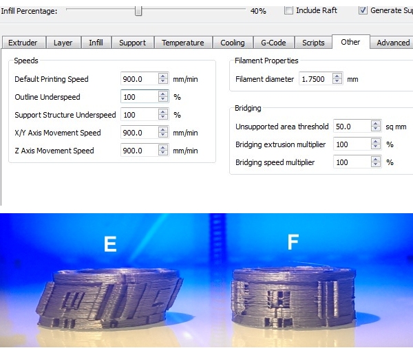

As mentioned above this test was run extremely slow to prove that speed is not causing skipped steps.
The print typically takes about 40 minutes and each one of these took over 2 hours to print.
Part E
Parameters the same as Part D above but printed VERY slow with retraction turned on.
Result = Part is extremely skewed.
Part F
Same as Part E with retraction turned off
So there you go folks. Am I missing something?

Festus440
Posts: 77
Joined: Wed Aug 07, 2013 8:38 pm
Re: Major bug, x-axis leaning to the right (positive)
Mon Apr 21, 2014 2:23 pm
For Part D I turned retraction back on, turned off the bed and cooler (plus disconnected it).
I then hit "prepare" and printed it.
For E and F, all I did was turn off retraction on part F, prepare, and print.
There are no negative values in either the Slic3r or the Kisslicer gcode anywhere except at the very beginning.
S3D has negative values all through it:
