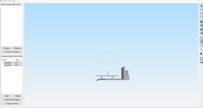

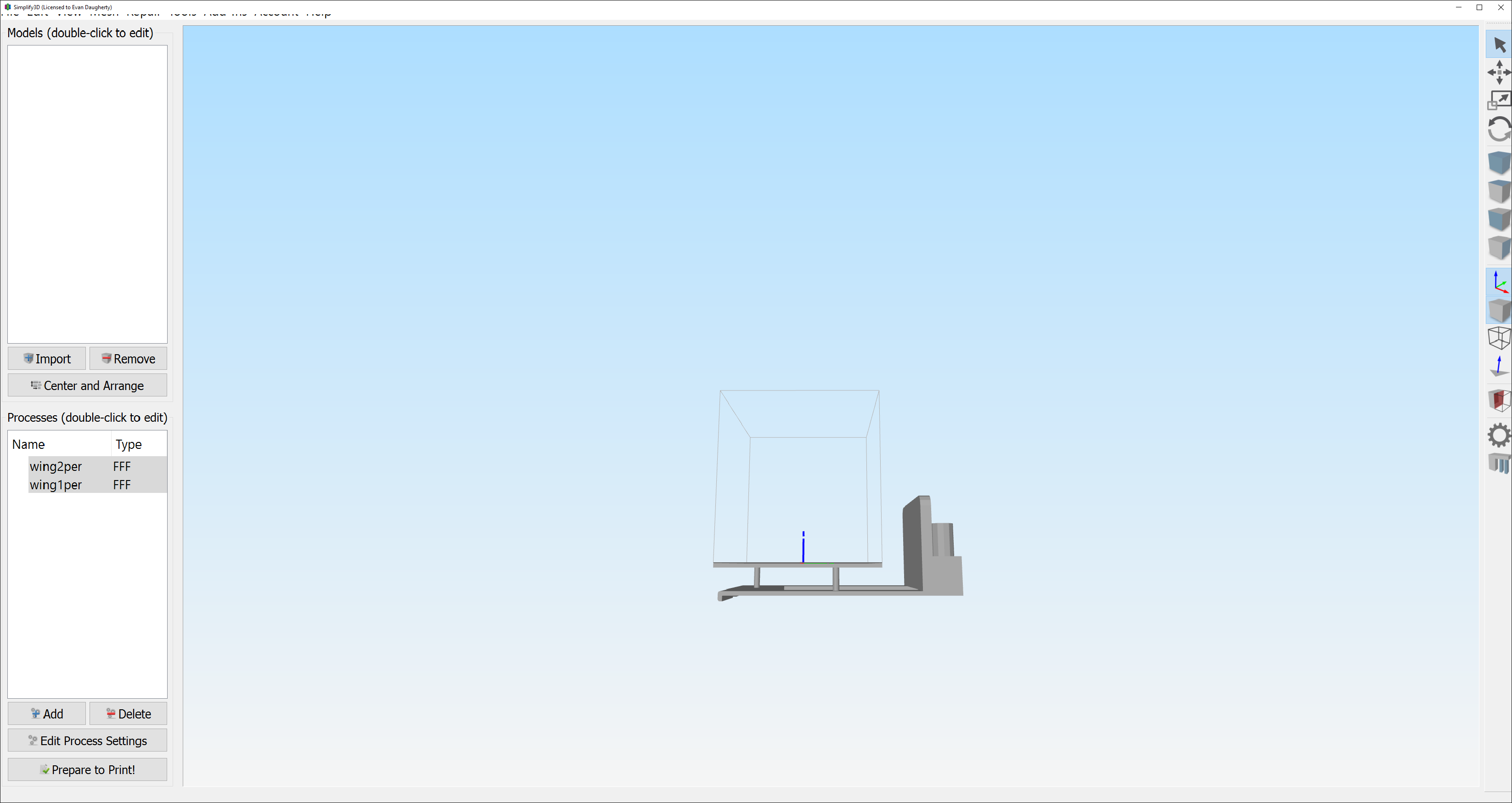

Has anybody run across this after installing the latest version on a windows 10 64bit machine? All the clickable areas and buttons of the UI are offset and the menu bar at the top is halfway cutoff. This means where the cursor is and where I'm clicking do not line up. Very frustrating.
I initially thought it was a resolution setting on my machine, which is a 4k screen, though after cycling through a couple lower resolution settings it appears to only get worse.
