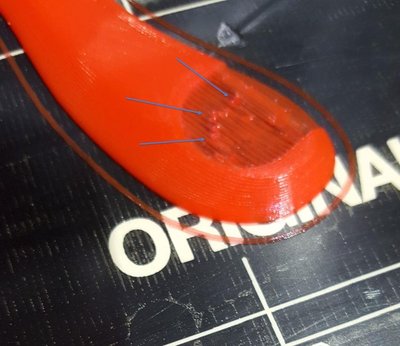

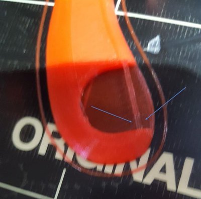

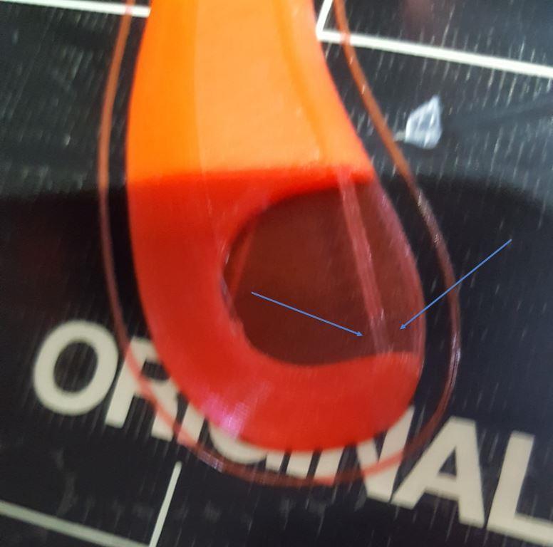

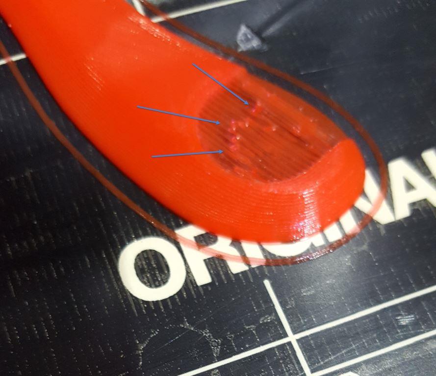

Here are two pictures showing a bridge that didn't work well. The area is about 10mm across. Using PLA.
In the first picture it is harder to see but the arrows point to the start of the perimeter where the first few mm are extremely thin then the flow starts.
Bridging speed is 90% and multiplier is 95%.
In the second picture you can see as indicated by the arrows what is very "clumpy" extrusion.
Thanks for any suggestions!

Re: Poor Bridging Question
It's a customer file so at this time I can't attach the FF.
To me it seems it should be a simple bridge to span a small opening.
I reset the bridge settings back to default but it didn't help.
I was letting it bridge this area so to not have to use supports in the cavity.
