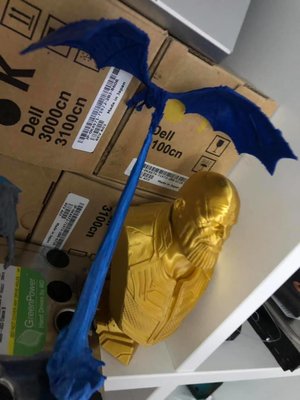

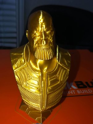

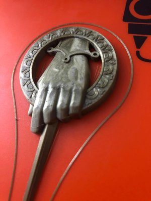

Here are some test prints. That is a hard drive under them for size reference. (The dragon and the girl are old/test prints.)
