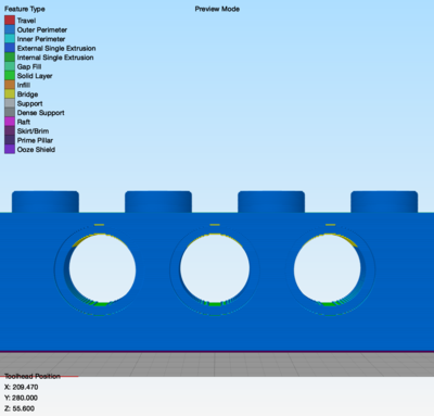

I’m happy to state that this issue should be resolved now in the latest 4.1.1 release. Our team successfully tested your factory files from threads mentioning this issue. The combination of coasting and apply
bridging settings to perimeters will no longer result in the
bridging settings getting applied to non-
bridging regions. This was just one of many improvements to the software. All of which are detailed on our
Release Notes page.
- Technic_brick sliced in 4.1.1
