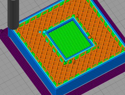

Or an option to inflate the external Infill by a (mm) amount if adjacent to internal infill would be perfect. Just like the option to inflate bridging there would be expand external infill. This is the one thing S3D does less then poorly.
The logic is already there in their code. Just need to apply it here.
I find myself spliting a process when I do catch this (a real pain)
then the internal infill captures the layer below it so you end up with something like this. But if thing are on an angle... forget it. ask here
viewtopic.php?f=23&t=12895&hilit=inflate with no response but same thing.
Even making the internal infill solid does not work as there is no overlap of internal to external option just outline overlap.

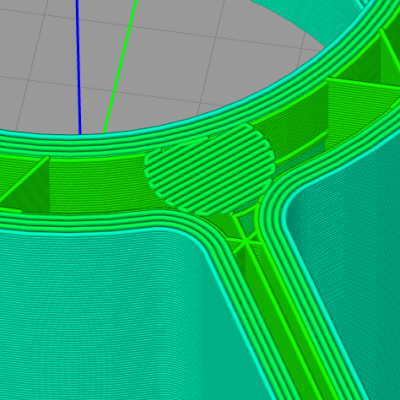

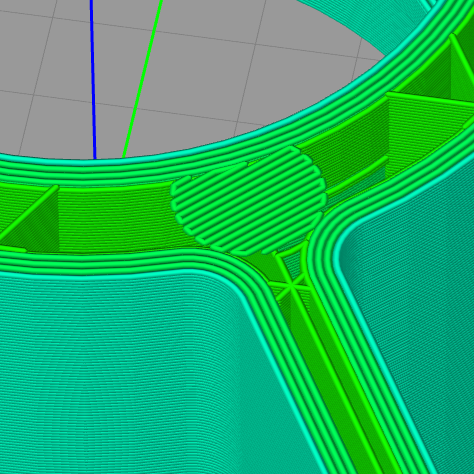

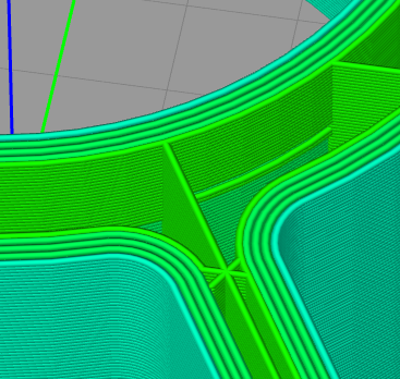

This is definitely still an issue in the latest 4.1.2 version. In any print with low infill and internal floors this leads to issues, sometimes even causing the print head to crash into the uneven surface. Here's a pair of images showing what seems like a worst case scenario.
