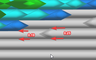

Would still like to control the Gap between support by distance in one process. It can be done but still need two separate processes. Would be great if a check box is "support gap by distance". How it can be done now.

let's say you want a layer thickness of 0.25 and a gap of 0.19 at top between support and model
For "Model" process set First Layer to Absolute and 0.25 + 0.19 = 0.44 as the height value

Now "Model" will print only model and "Support" will print only the support where the model is 0.19 mm above the support interface governed by first layer height + gap in the "Model" process.  All the options are there just takes a but of work to get it to work. Most slicers only allow layer to be skipped. Even cura says height by then round up to the next layer height.
