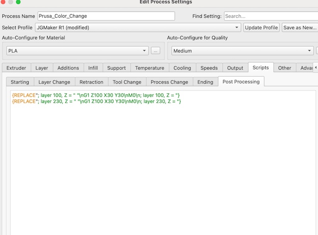

The way I understand it is in the scripts section, the Layer Change tab, I put this into the Prelayer Change?
{REPLACE"; layer 100, Z = " "\nG1 Z100 X30 Y30\nM0\n; layer 100, Z = "}
{REPLACE"; layer 230, Z = " "\nG1 Z100 X30 Y30\nM0\n; layer 230, Z = "}
then the printer should pause at those layers for me to change the filament and then hit RESUME?
Thanks
Allen
Re: Pause at layer Question
Posted: Sat Sep 14, 2024 4:29 pm
by allenzag
Okay WOW! Tested and working great.
The script went into the P
ost-Processing-Tab
