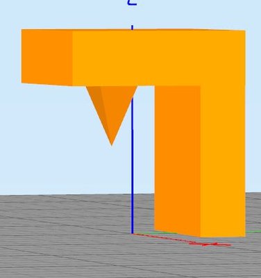

That example file is just that: A terribly obvious explanation of the issue to expose it. I'm not printing stuff that exposes the bug as directly as that, and you're right, without additional support on the sides it would probably tip before connected. And in that case I'd be happy to go in and manually place some support pillars to hold it up.
What I'm printing is akin to a cave roof with stalactites : S3d Won't catch any of the stalactite tips, so you have to manually place support for them all: If you miss any, you get spaghetti pouring from the roof of your cave. And sometimes this is non-trivial based on how the model was created, with external bits occluding the interior, and the already-existing support blocking your view as well (see below).
I encounter this issue infrequently, but that's where the problem lies: It's infrequent enough that I forget it's a problem. I expect the slicer to place supports where it should: If something is suspended in the air, and you tell your slicer to provide auto-supports, it's ironic it supports everything but the feature that need it most.

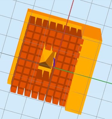

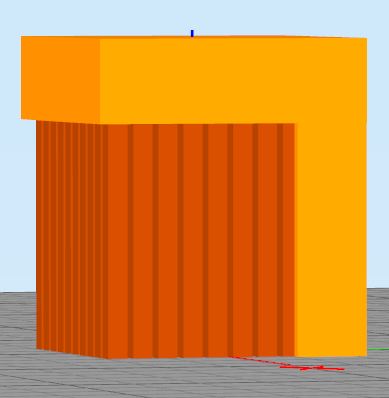

Here's another example:
Best model evar! Time to print!
Auto-added supports. Super supported no doubt:
Wait, why is part of it completely unsupported?
So trying to find all these unsupported areas while surrounded by valid support becomes a real pain on an asset more complex that this.

I haven't tried it myself but am guessing you would still need to change the minimum support angle. Just because it is upside down doesn't mean it isn't still below the minimum threshold, which that upside down cone looks to be. I will have to try it myself to see. But I could see how that would be frustrating.

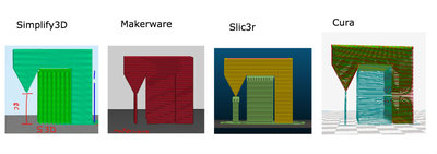

I agree that the software is looking at it very black and white. The problem is, it's colorblind: It doesn't know it's missing this feature, thus it's not computed. S3D only deals with overhang, it appears to have no concept if an item is touching the build platform or not.
Let's compare against other slicers:
Makerware, Cura, and Slic3r can all do this, easily. No crazy tweaking is needed. No compensating for overhang angles, because this isn't an overhang issue. This is an 'unsupported floating feature' issue.
This either falls into a bug category, or missing feature category. I really don't care which, but I'd sure like it to be "supported" (get it? ;) )

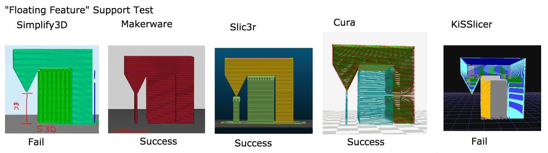

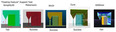

I tried your model with Kisslicer and got the same results as S3D. Can you do the same and post results?

I've never used Kisslicer before, but I gave it a shot: Looks like (unless we're both missing it) it suffers from the same problem S3D has, and wouldn't support that feature either. I couldn't find any setting to make it work. Updated the image:

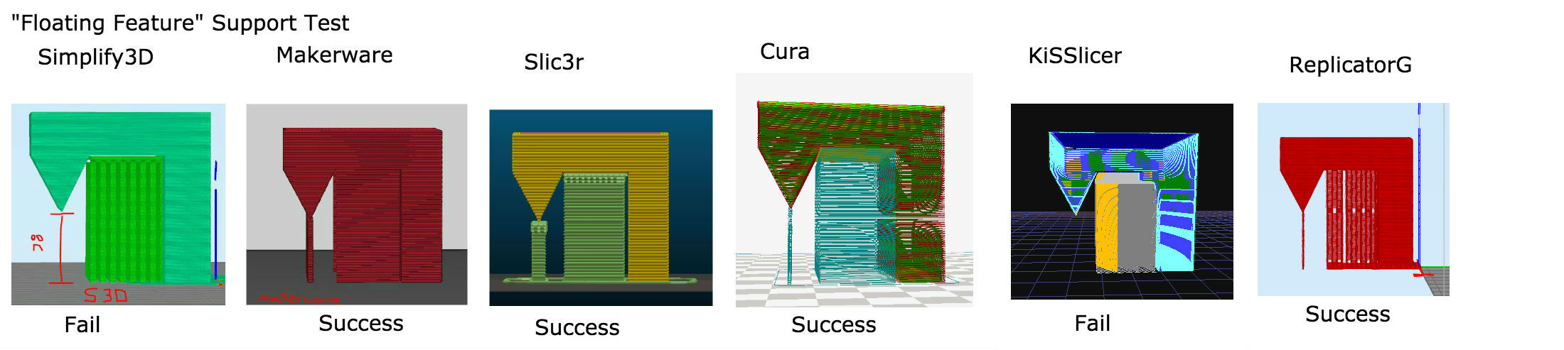

To add insult to injury, ReplicatorG passes the test. Man I forgot how slow that slicer is, and reminds me how much I love S3d ;)
