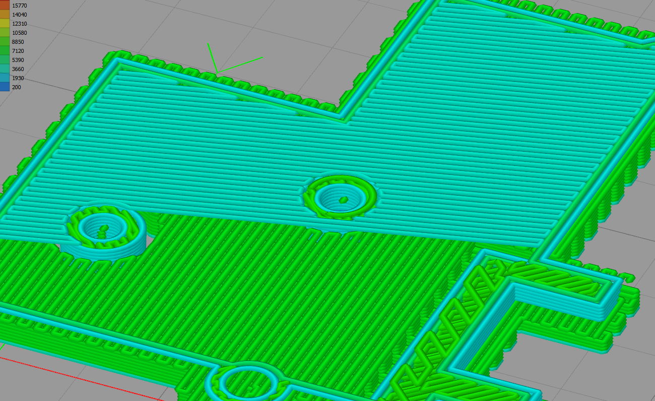

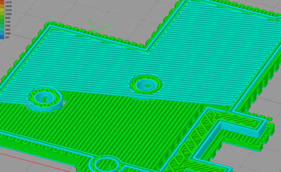

horst.w wrote:This factory-file is for me without any issue.
The center-area, where the cylinder will be build, has no
top-layers and that seems normal for me.
The last
top-
layer:
The first
layer builds up the center-cylinder:
Following layers:
If this is a stationary ornament I might be persuaded to agree.
If on the other hand it is designed to rotate and or flex about that central hole, the part strength would almost certainly be improved by continuing the 'last
top-
layer' further under the subsequent wall. In fact I couldn't be happier if S3D defaulted to making
top layers 'all the way to next inner wall feature if it exists' over the current approach.
I also disagree with your later suggestion to use 6 - 8 perimeters to coerce S3D to be more generous with extent of
top layer under walls: It's needlessly wasteful of material and time. Except as a means by which to get S3D to provide more '
top layer under wall', 6-8 perimeters has been unnecessary for any 3D printed part I made in the past four years; if ever I needed such solid walls I've needed a solid part.
