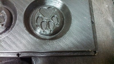

Here is what my caps/ flats still look like, please help

Bowmaster,
Are you using Kaink's 15-18% adjustment, or the 5% default, or ??? Other details on material, settings, etc? Nice print! My top surfaces are still just a tad rough -- I'm using 20% infill and 3 top layers.
