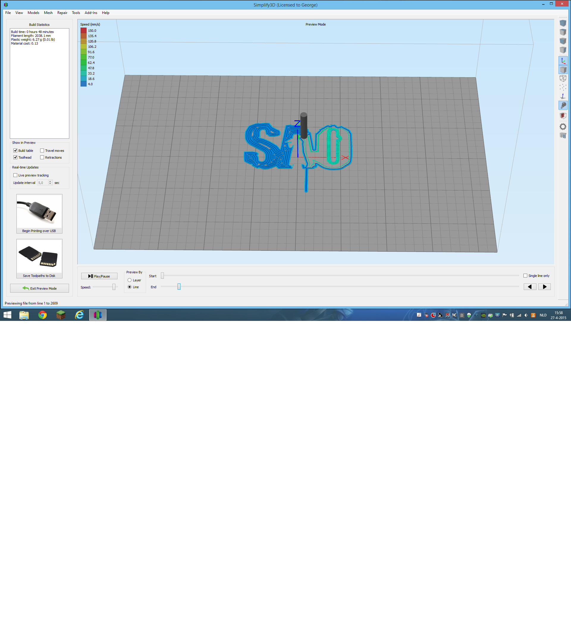

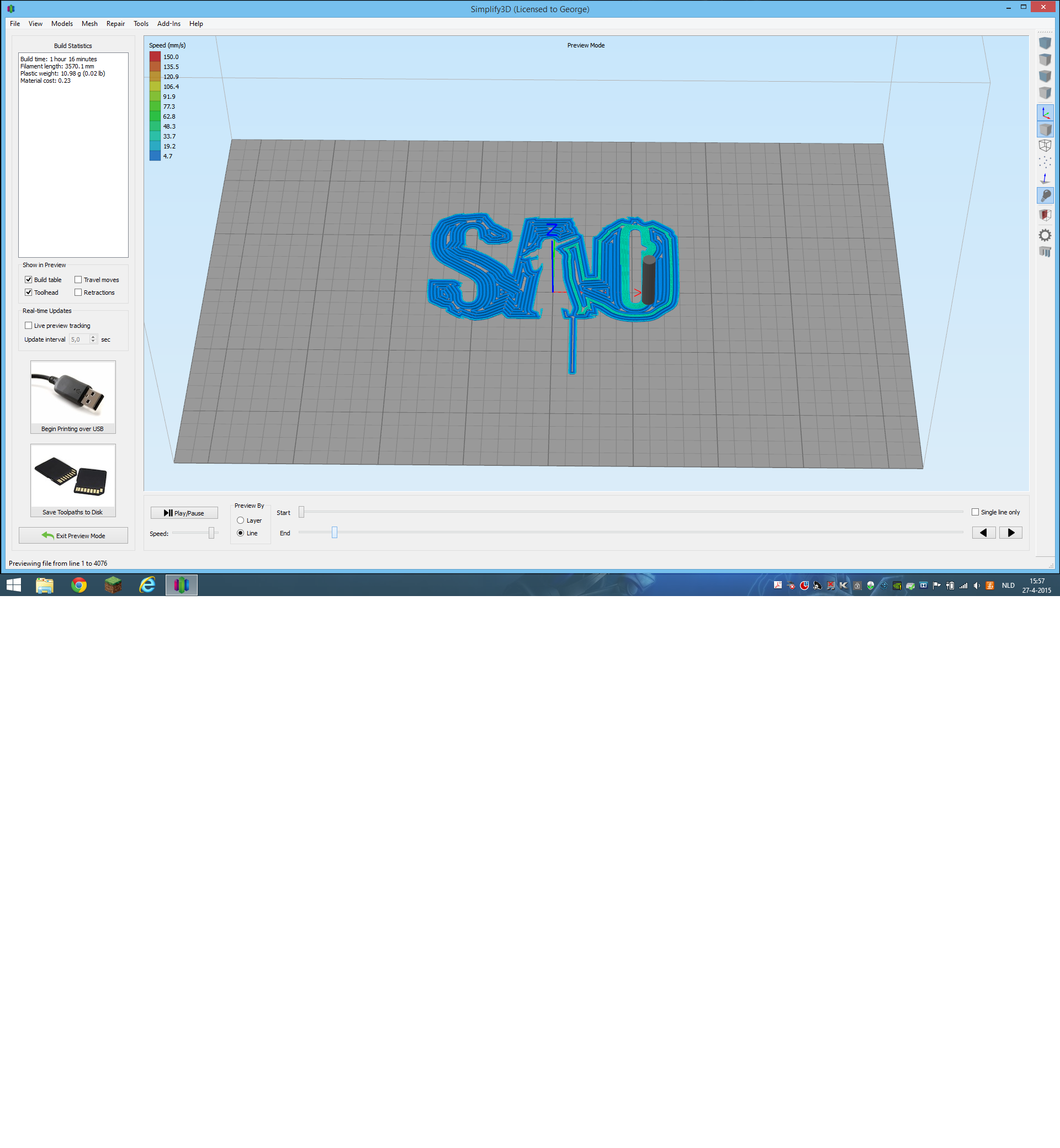

The slicer mismatches the first layer at certain prints. I show you in the pictures:
First layers are perfect
First layers are forgotten at some point?????

Can you post a factory file? Also, what printer are you using?

It's the slicer, not my hardware. This is a preview.
Sorry, but I'm done with this software, so many problems and no solution. Wasted more than 100 hours I think.

Few things I changed.
Concentric Infill-->Rectilinear (Concentric isn't the best choice for this part, Concentric generally works well for geometric shapes)
Outline Overlap from 15% to 30%
Minimum Infill Length from 5 mm to 3 mm.
Also change the First Layer Extrusion Width down from 250% to 125%
You can immediately see in the G-Code previewer, the slicing looks much better

I think in that Factory File I uploaded, I may of saved it prior to editing your First Layer Width to 125%. Be sure to change that when testing, but resizing your part shouldn't make any difference for these settings.
However, if you were using the default profile for the Wanhao Duplicator, (Help-->Reset All Settings) I think your print settings would be really good, it was just that concentric was the biggest issue for this print. The default profiles typically work really well from my experiences (simple :D )
Your First Layer Width of 250% isn't ideal, that would be attempting to print at a width of 1 mm wide line out of a .4 mm nozzle. The First Layer Width is applied to the first layer that touches your bed, so that setting was being applied to the bottom of your raft, not the bottom of your part. Using settings closer to the defaults, such as 100-125% for the First Layer Width should offer a much better bottom finish to your part (without a raft).
