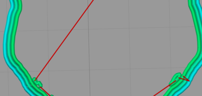

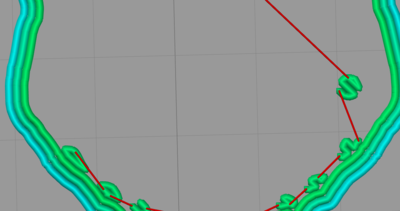

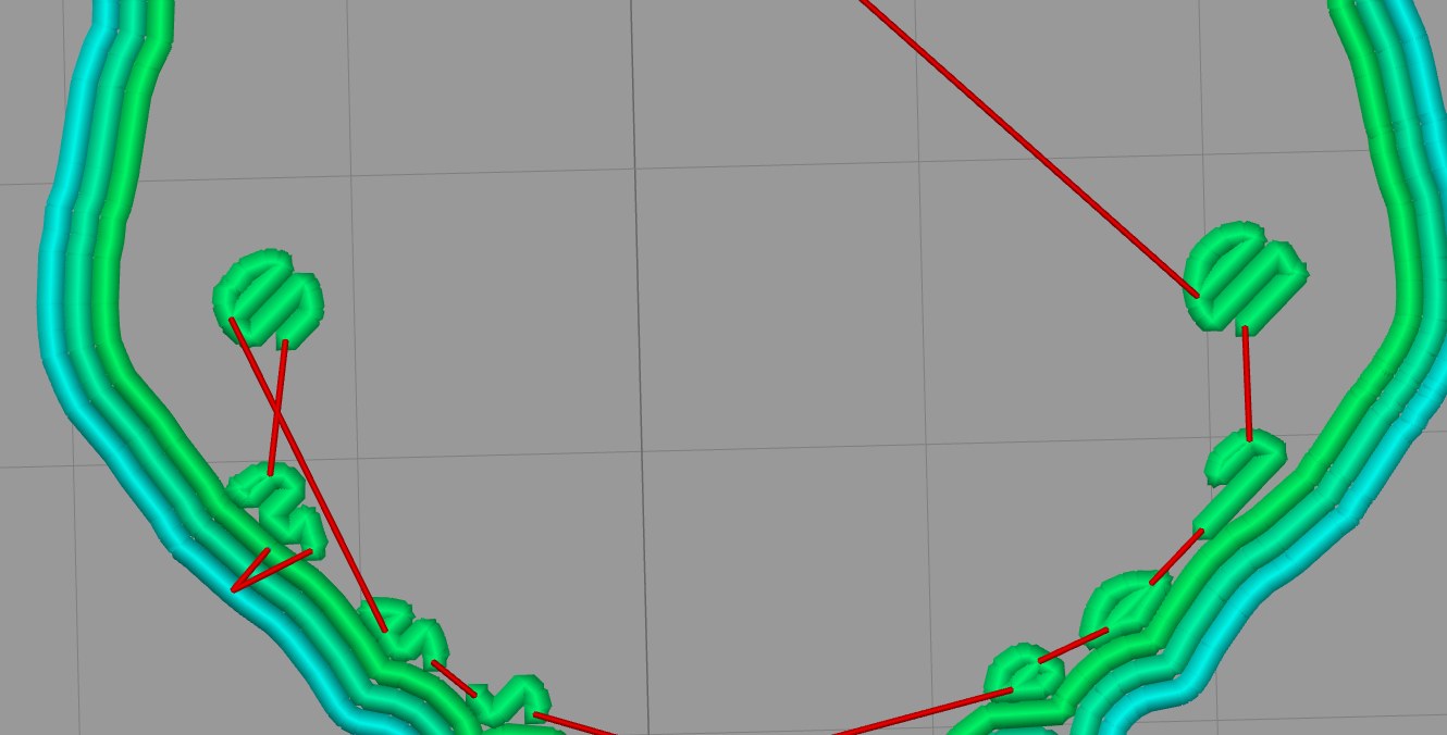

Hello,
Strange behavior of the s3d. Maybe it's normal.
I print with 0% infill. Object can stay itself with shell only (cat statue)
At a certain layer, s3d try to print on void (inside object). Take a look on follow pictures.
001
001
002
002
003
003
Is there somewhere a parameter where we can force 'inside' support ?
Please, don't suggest fill the object because even with 20%, it doesn't work, and I don't want infill !
Thanks in advance.
Jean

S3D doesn't create internal support. You have to specify that yourself.
Looking at your print, the trouble starts around layer 568...and then is okay until around layer 820. At both these points, you'll need to have some infill to allow something for the newly extruded plastic to sit on. This doesn't mean you need infill all the way from the bottom, as you can have different process with differing infill %ages.
I've never done this sort of print myself, so I am not going to offer suggestions of how much infill is needed and for how many layers. Perhaps others can offer this sort of advice.....

Look at the slicer simulation at layer 568 and you'll see there's a depression in the back of the neck where there's printing over fresh air. The same happens where there's a depression inside each of the ears at around layer 820. The model needs some infill to support these depressions.
The issue Jean is raising is that S3D only creates external support, ie support material external to the shell of the model.....and doesn't look to create support "inside" the shell where the infill has been specified as zero.
Not sure if this might be a subject for discussion as a possible enhancement......
