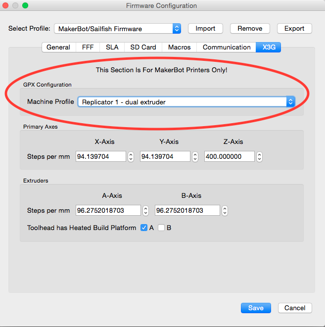

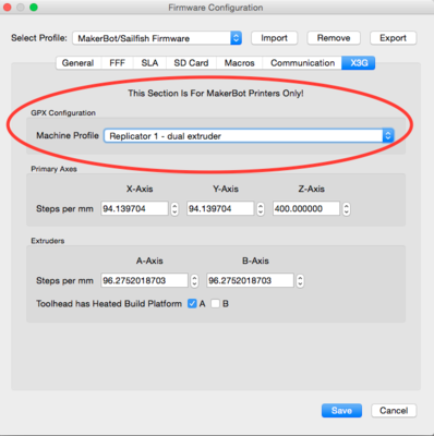

In your firmware config (Tools --> Firmware Configuration), do you have it configured for MakerBot/Sailfish type printers? If so, you should have an X3G tab that should be set to Rep 1 dual.
X3G tab!
X3G tab!

Well the checkbox for the M1XX commands no worky
and here is the Firmware setting that is/was already selected
