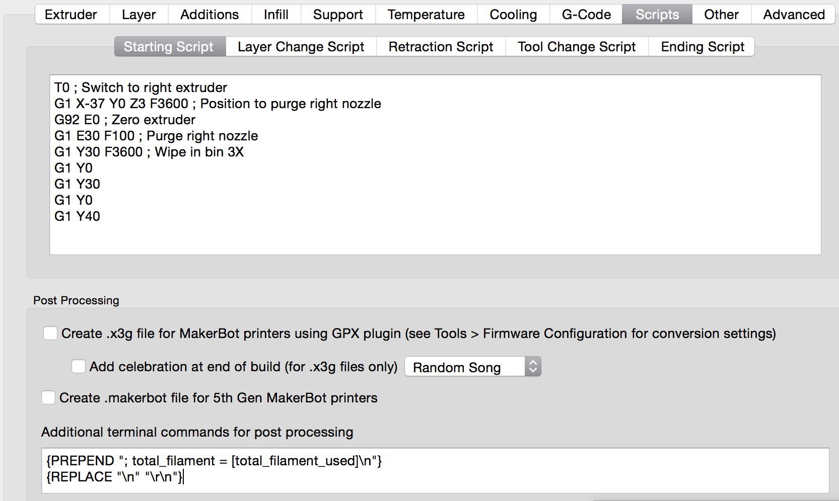

BaudR8
Posts: 183
Re: DaVinciXYZ Printer shuts down during upload
hammboned wrote:
BaudR8 wrote: in the scripts tab, in post processing under the prepend script, put in:
{REPLACE "\n" "\r\n"}
Where do I find this? I went into "edit process settings" > "scripts" > "end scripting."
Here is what I have there:
M103 ; turn off extruder and retraction
M104 S0 ; turn off extruder
M140 S0 ; turn off bed
M107 ; turn off fan
M127 ; turn off valve
M84 ; disable motors
Am I supposed to but it at the end of this part? Sorry for my ignorance lol.
No problem, in the Scripts tab, in the box that says "Additional post processing", add it to the bottom of that.

hammboned
Joined: Mon Apr 06, 2015 12:09 am
Ah... I completely overlooked that portion for some reason. Thank you for your assistance. It is much appreciated.
