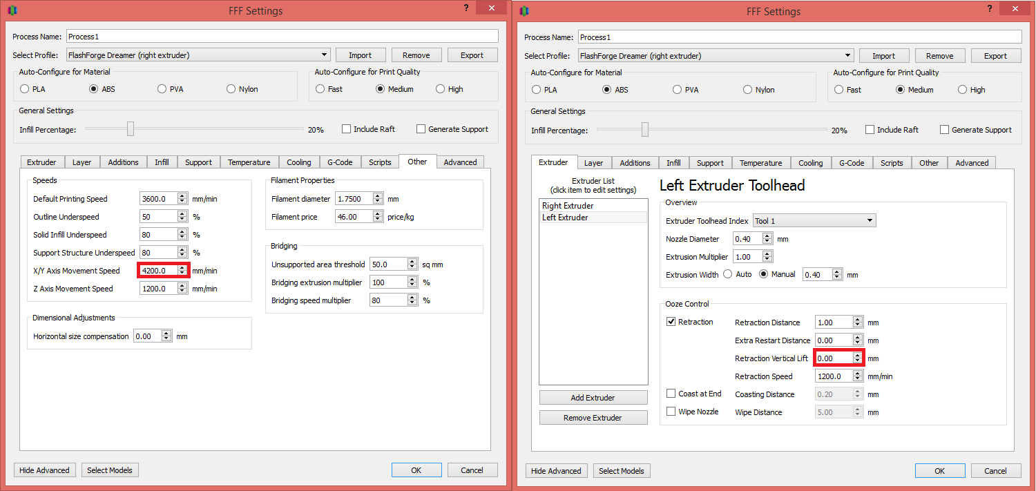

If you need help finding these settings here's a visual:
XY Movespeed / Retraction Vertical Lift
