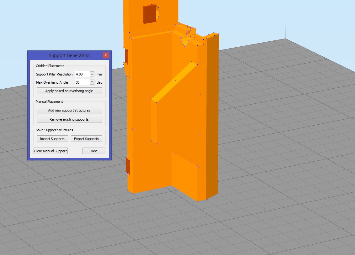

Can't get Add Overhang based on Angle to work
In the piece I am trying to print I have the overhang max set to 30degrees but the part in the image will not get any added to that front section that has about a 45 degree overhang. I have to place it manually

You may need to turn the resolution down from 4 mm to a smaller size to fit that area.

KeyboardWarrior wrote:You may need to turn the resolution down from 4 mm to a smaller size to fit that area.
That was it, THANKS!!
