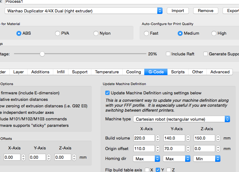

The Build plate size in the Wanhao D4S profile is too small. Had some prints from Thingiverse made for a D4S but were a bit too big for the Build Plate. So I measured the plate and filled in the following values under Tools > Options > Machine.
Must be X-axis: 220mm
y-axis: 140mm
z-axis: 150mm
After this I can print all the files.

The current volume is 220x140x150 . I believe you mean that the X-axis should be 225?

PinballGeorgio
Posts: 94
Joined: Sat Apr 11, 2015 10:58 am
Re: Build plate size for D4S
I now have the problem that this setting cannot be saved. Everytime I start S3D and build something big I have to adjust this setting again.
Is there a way to keep this setting?
KeyboardWarrior
PinballGeorgio wrote:I now have the problem that this setting cannot be saved. Everytime I start S3D and build something big I have to adjust this setting again.
Use the export button to export a new .fff file, then import that newly created file.
PinballGeorgio
Posts: 94
That doesn't work. Even if I change the infill settings as example, the build plate dimensions are back to standard.
Have to correct this with every setting I make.
KeyboardWarrior
PinballGeorgio wrote:That doesn't work. Even if I change the infill settings as example, the build plate dimensions are back to standard.
Under the G-Code tab, there's the option for Override Machine Definition with settings below,
if that box is checked, it will change your build size dimensions.
PinballGeorgio
Posts: 94
Thanx! You're great, that did the trick!
