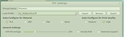

Is there a default configuration for M2 I can reload? I have messed a lot with the configuration and It seems all my changes have been saved as Process1 as i have been playing with my M2 and now have no ideas what the default settings were.

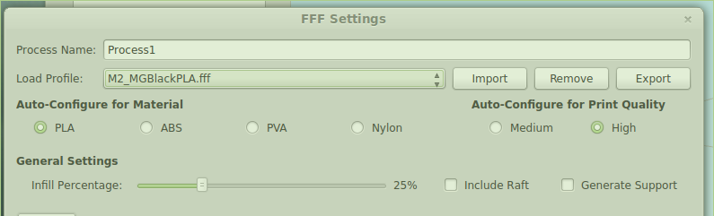

In the FFF Settings window, click the spin button to the right of the "Load Profile" box and select MakerGear M2. See the attached picture. (Sorry for the green tint. Screenshot in Linux Mint captured its own highlighting for some reason....) I believe that will load the default. There are defaults for a number of printers, plus one called "Default" --- not sure what that is!
You might want to save the one you've been using with a Process Name other than "Process1" first.
Thanks for the quick reply. After looking into it closer I find that I get a reset of values when I choose a different machine and then back to MakerGear from that profile selection popup. I had thought i had tried it before and not seen it reset my values.
After your response I took my time double checking and all seems well.
