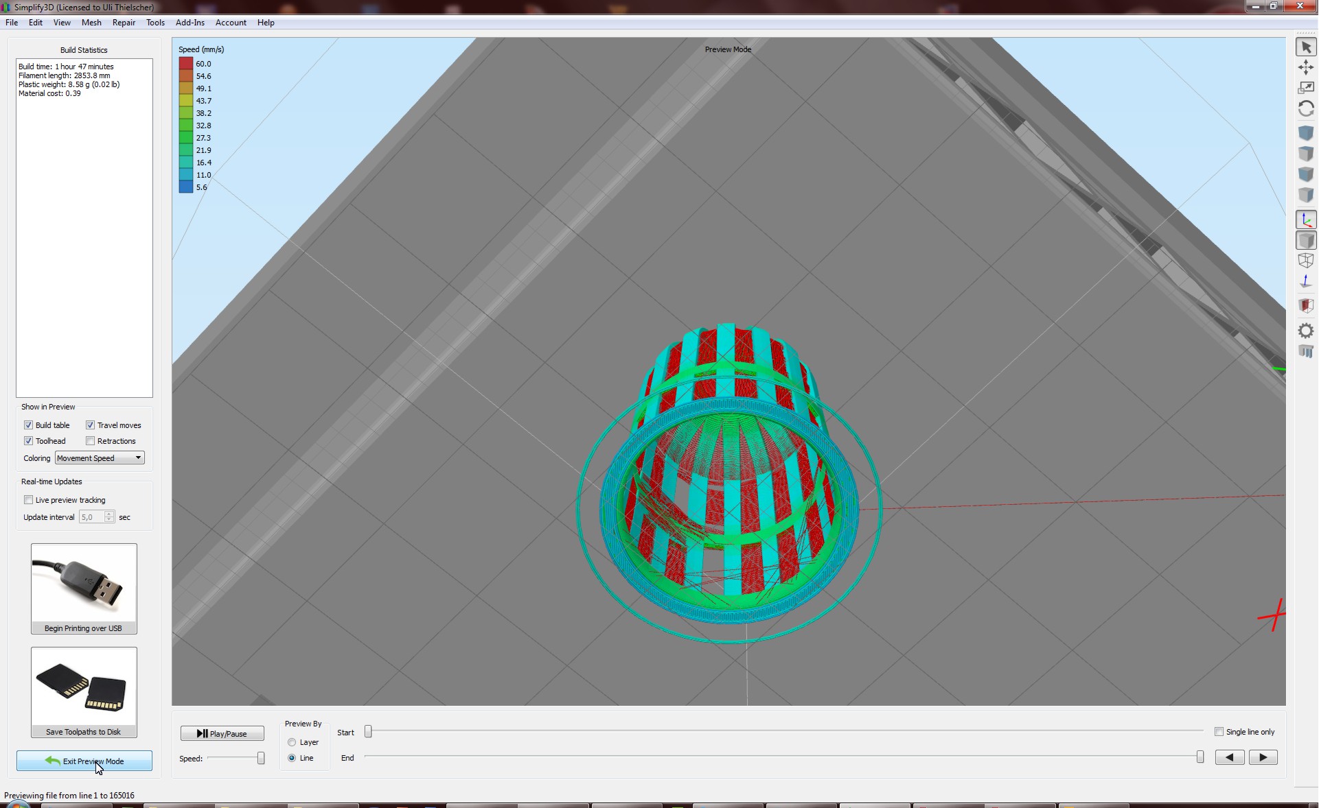

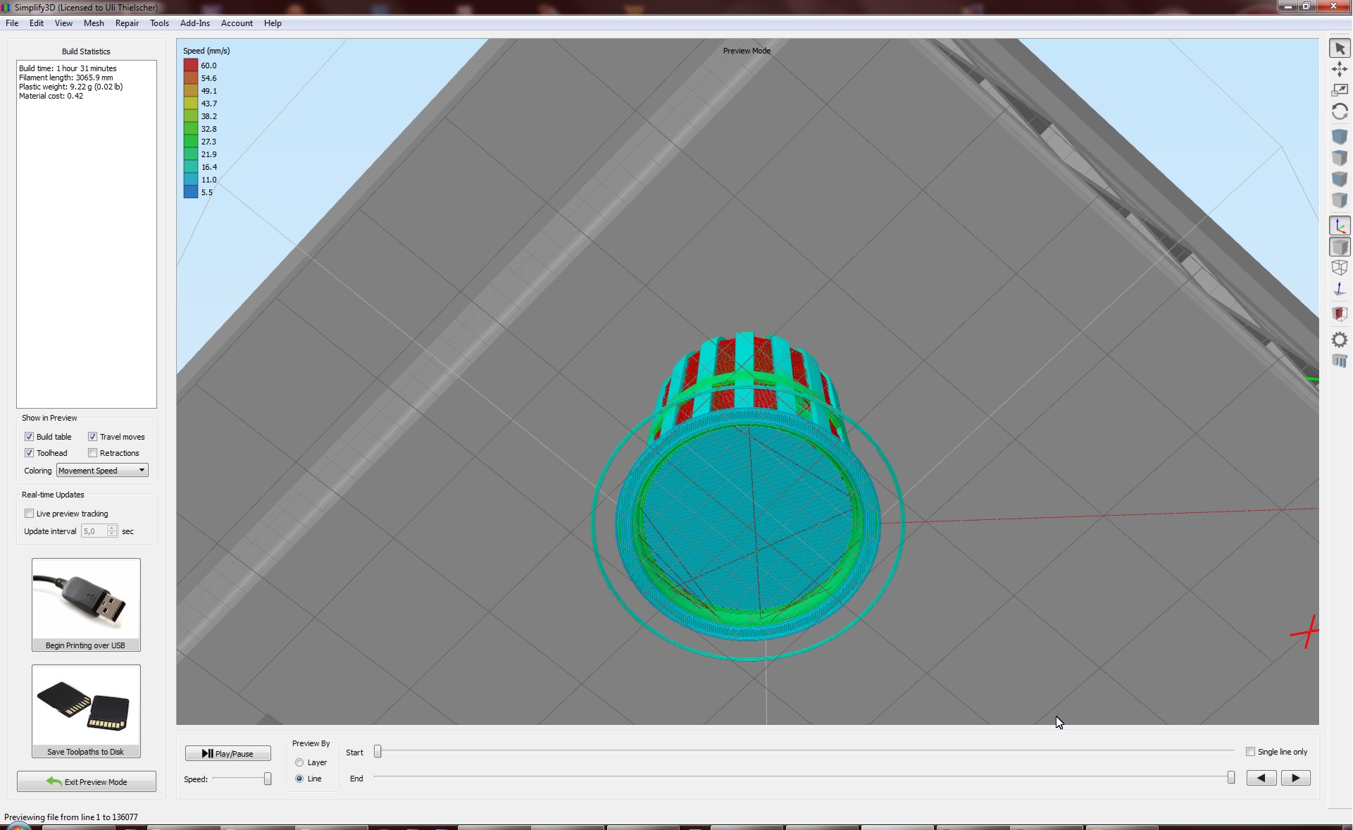

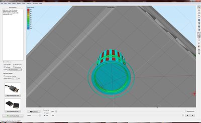

Hello,
have the same problem with 3.0.1.
DaVinci 1.0A
When I start a new process, everything works fine (Slice02).
Correct
Correct
I printed the model. When I change parameters, e.g. speed from 30 to 35, the new print preview shows like slice01.
Incorrect with support
I am no more able to remove this unchecked and unwanted support.
I have to start a whole new process and make all my changes again.
Even restart does not change the behaviour.

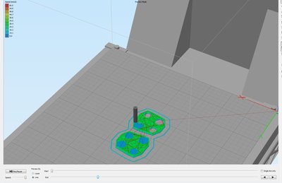

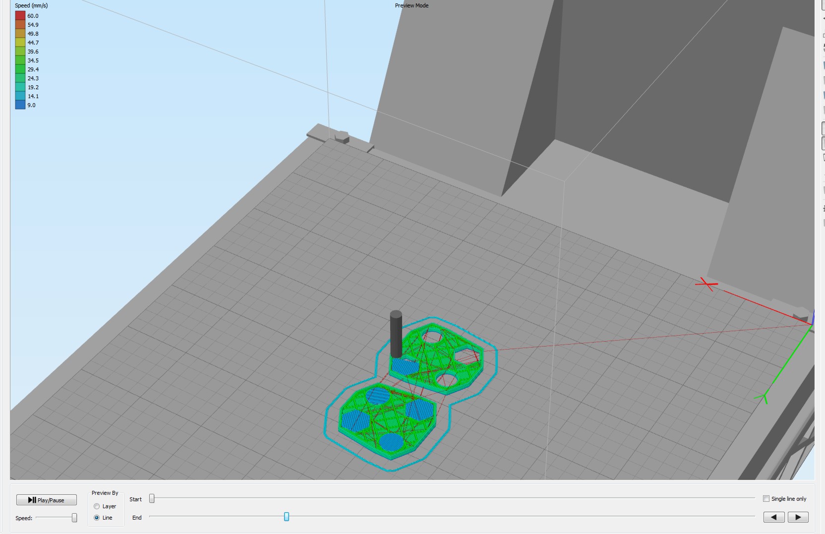

It's not relatetd to any specific object.
Just tested some others while no errors where produced.
But same strange results.
When I set my process settings fresh from the profile and hit "prepare to print" - it works just fine.
But at any point later, I want to change some settings, holes are closed with support - not starting at the first layer.
See this screenshot, when printing "support" starts.
Those holes are supposed to be open - and printed just fine before just changing temperature from 190 to 185
