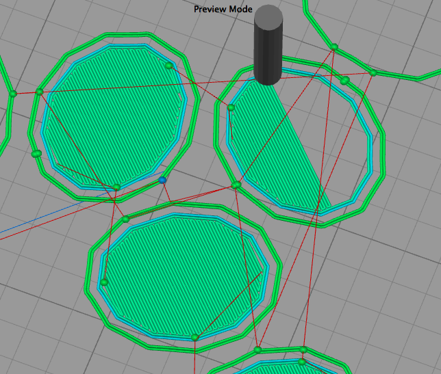

I have a model in which the first layer has multiple disconnected islands.
Any skirt settings, whether for priming, or to increase the footprint for adhesion, do not appear to use the retraction settings specified for the rest of the model - retraction only seems to kick in when the actual model itself is being printed. This leaves a gooey mess on the print bed in between the "islands" of the skirt.
Also, in other slicers, the skirt (if not touching the model) typically gets calculated to surround the entire footprint of the model with a single skirt, rather than multiple skirts for each island. What is the "by design" behavior for the 3.0 slicer?
Example of the slicer output for the first few layers:

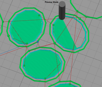

I'm experiencing this also. When the hotend travels between skirts, the filament retraction settings don't seem to take effect. Leading to strings between skirt "islands"
If you're getting a gooey mess, it may be because S3D is trying to optimize the start point of each layer. Setting a "specific start point" from the "Layer" tab and "Print islands sequentially..." should help organize the stringiness. I like Front (Y), Middle (X) of the bed lets me watch the seam from the webcam. Of course, keep the setting in mind when orienting the project. Rotate so the seam is least visible.

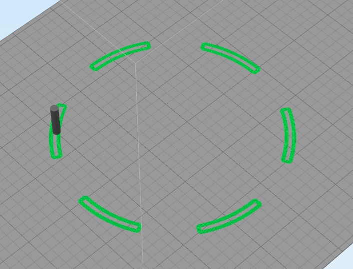

Re: Skirts not using retraction settings when printing in 3.
I just made a few test prints. Every time I had different skirt islands to jump between, the software added a retraction just like I would expect (see screenshot). I wonder if it's actually some other setting you have for your retraction behavior that is causing it?
