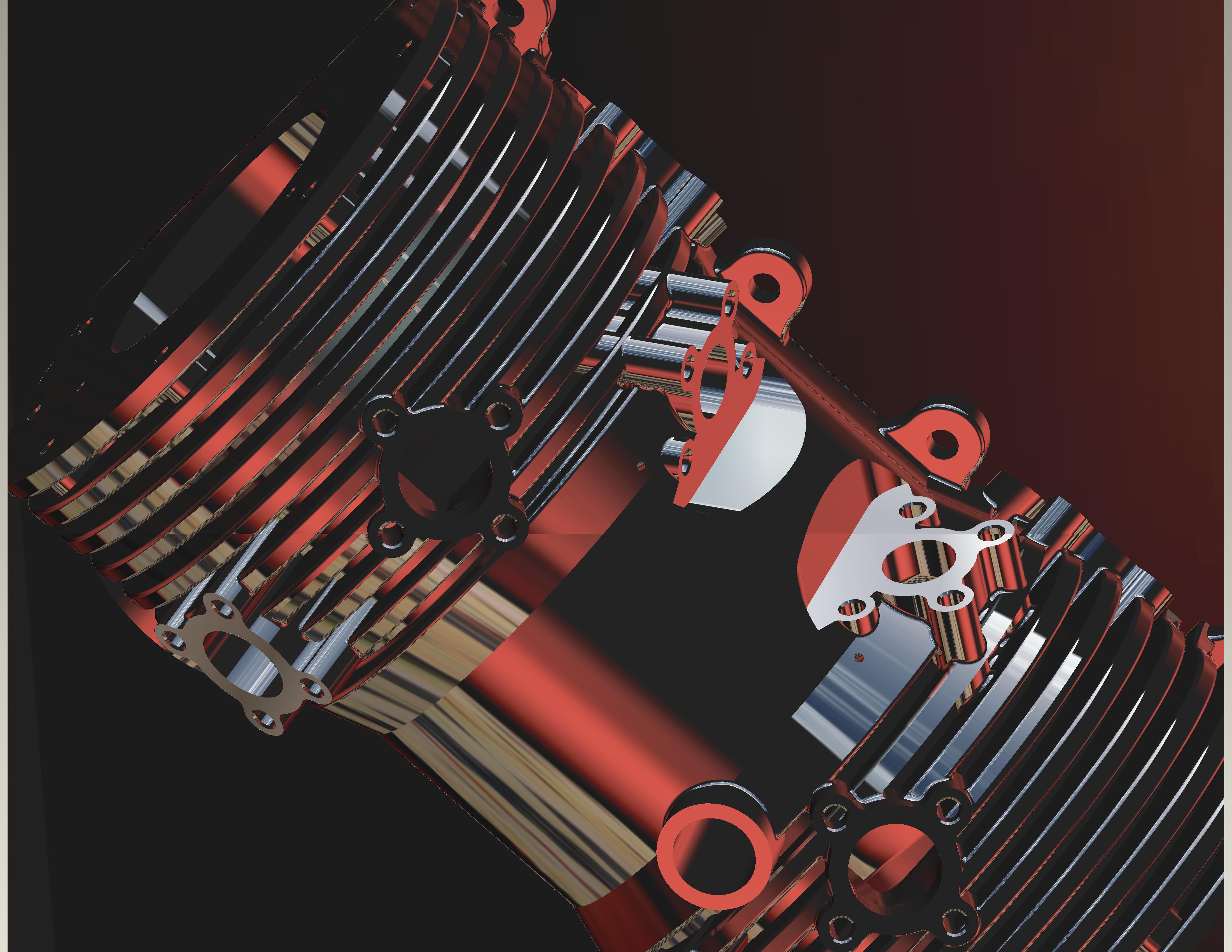

Again Dale, thank you very much. I have improved the quality of the print 10x in the last two days. 1st prints were horrible but as I have remedied each issue the quality has improved. My goal is to complete a large prototype assembly one piece at a time. I have started with a short run simple (oil plug) part and will work my way up to the cylinder which is about 9-1/2" long and has alot of detail.
cylinder
cylinder
