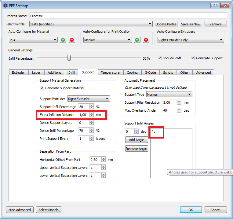

I normally print on rafts and I get a pretty good bottom finish, but when I use supports I don't get anywhere near as good a finish. Should I be able to get the same sort of finish with a support (basically just a higher raft)? I have a Flash Forge Creator Pro and am very happy with print quality except for supports. (No cooling yet - waiting for my fan to arrive). I'm printing PLA at 200c, 0.2mm.
Raft settings:
Raft Layers: 2, Raft offset: 3mm, Separation: 0.19, Infill 80%
Support Settings:
Resolution: 3mm, Angle: 45
infill: 30%
extra inflation: 0mm
Dense Support layers: 5
Dense infill: 75%
Print support every: 1 layer
Separation:
Horiz offset: .3 mm
Upper Vertical Sep Layers: 1
Lower vertical sep layers: 1
