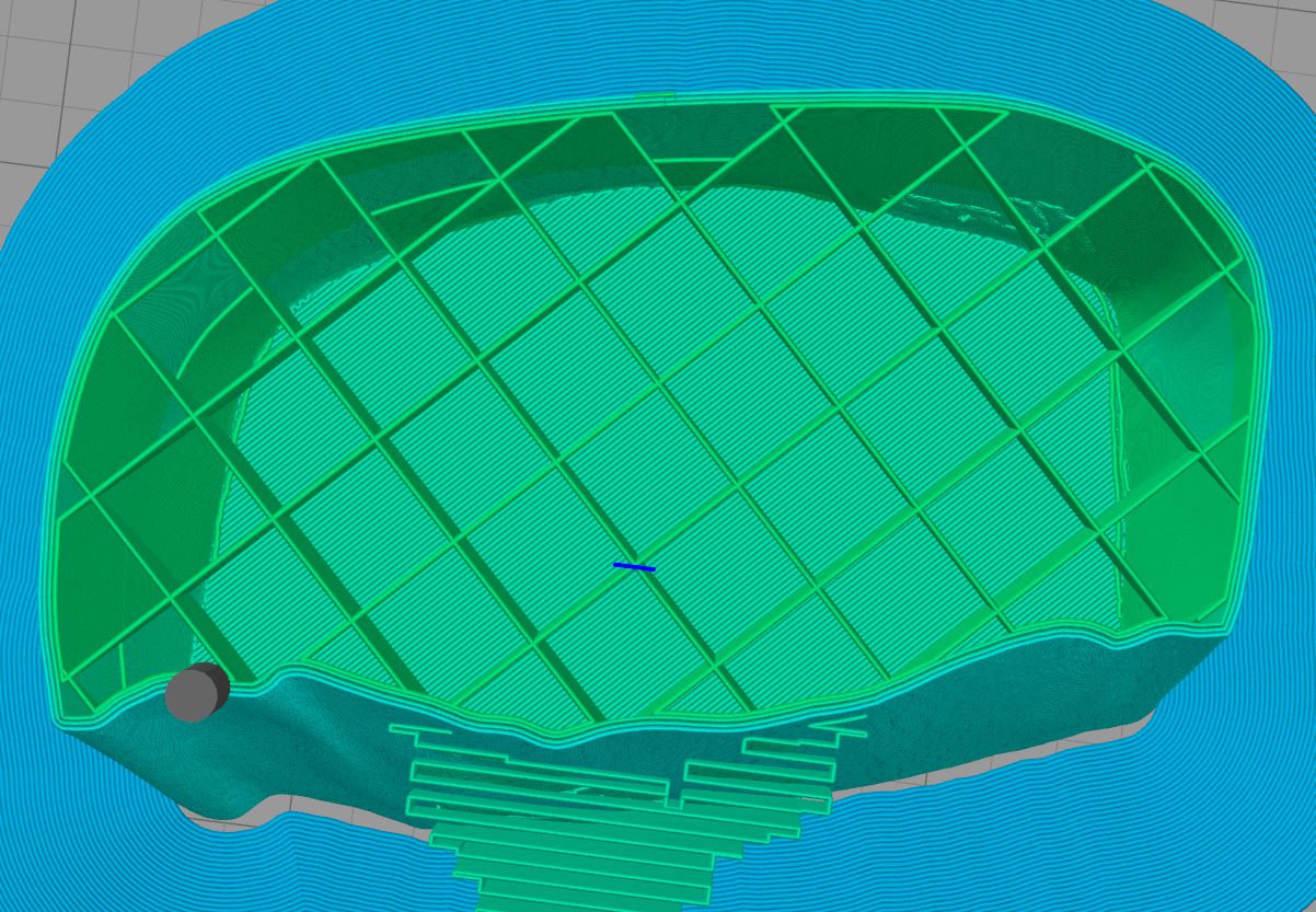

Most prints don't have enough movement travels to cause rattling. In my experience, rattling is caused by really jagged infill patterns. In the picture below, you can intuitively see why having one straight line filling in would be preferable to having the back and forth infill pattern. Using the setting in the Advanced tab for Gap Fill and raising it can help create more straight perimeter lines rather than the infill which causes shaking of the printer in many cases.

I just checked the preview on one of my prints. I see no jaggie infill patterns like in your example at all since my models are fairly large and round shapes (human busts)
