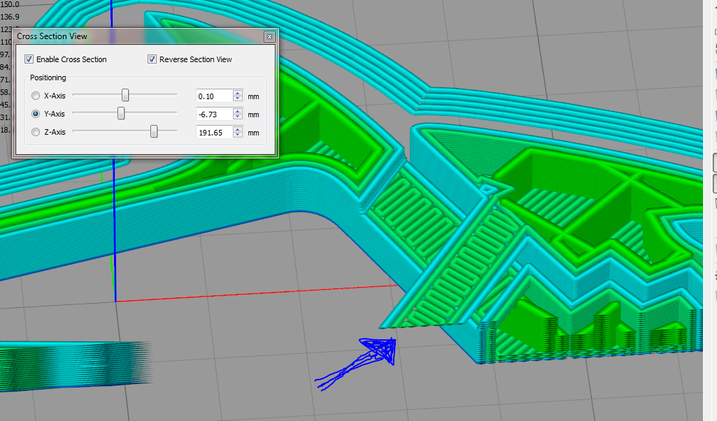

When printing the above model, there are two areas which are bridged. The S3D slicer appears to do something strange during the bridge which results in filament being dropped underneath.
Examining the above image, where my blue arrow is pointing, you can see that the bridge has two strands down each outside and then the middle is filled. The middle filling drops through the bridge.
How do I fix this?

I guess I posted the thumbnail of the image... this might be better:

Just set a really high bridging "unsupported area threshold" if you don't want it to do that. that settings is on the "Other" tab.
I put in 99999 and it went away
