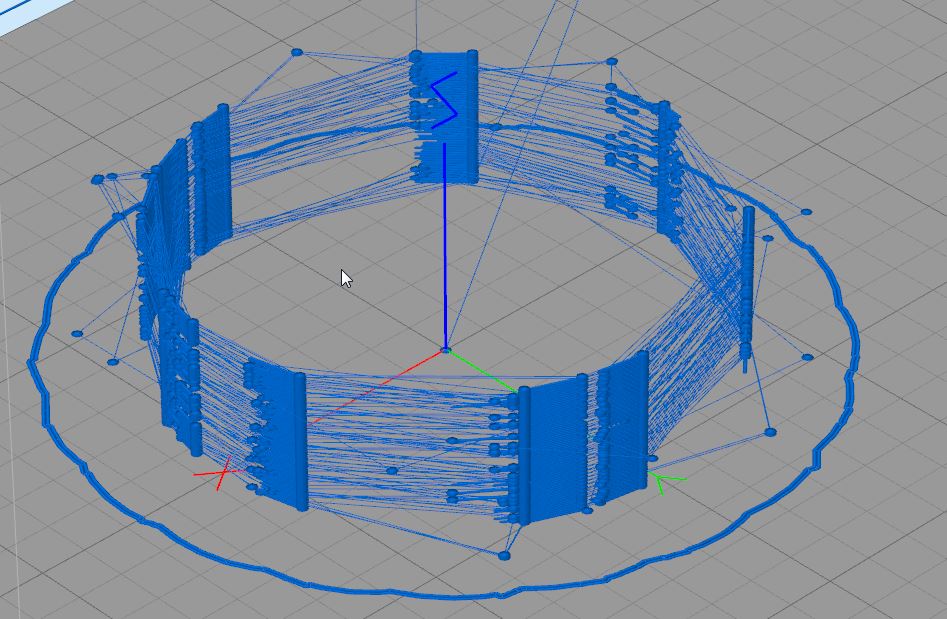

I'm not able to print this object with S3D 3.0.1: http://www.thingiverse.com/thing:13505
S3D almost prints nothing when using nozzle diameter and extrusion width of 0.4mm
S3D Nozzle 0.4
S3D Nozzle 0.4

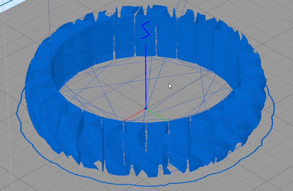

Even when both set to 0.2 and single Outline I got holes
S3D Nozzle 0.2
S3D Nozzle 0.2

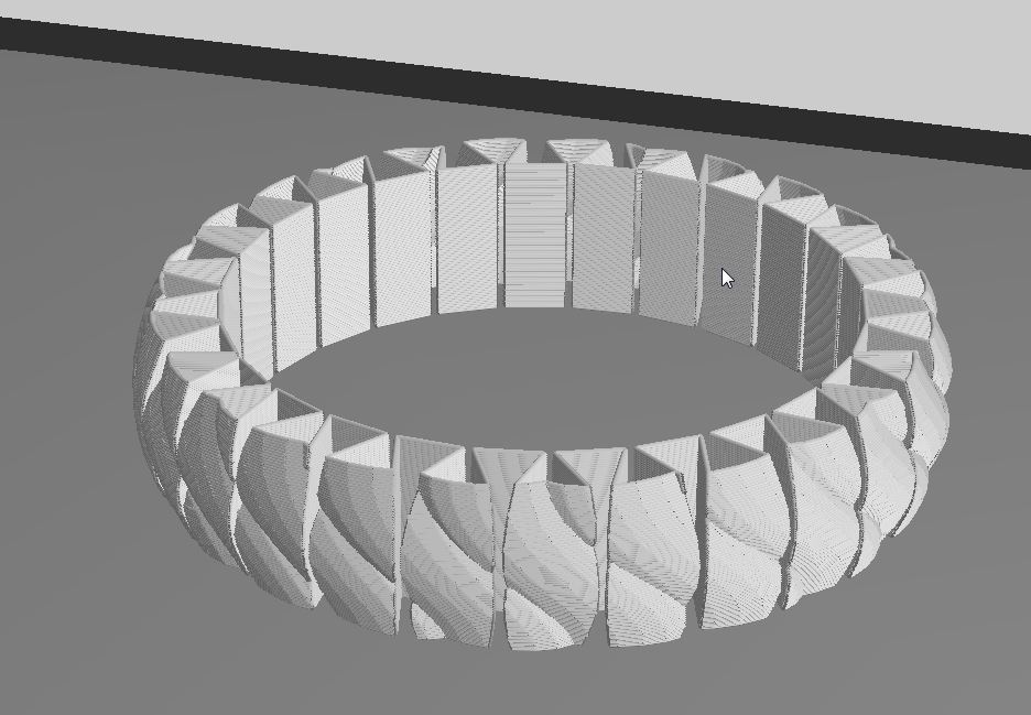

With Makerware everything is OK
Makerware
Makerware

It's because the software can't print walls that are thinner than the extrusion width that you specify.
An easy fix for this part would be to go to the Advanced tab and enable the option called "merge all outlines into a single solid model". This will make your thin walled part completely solid instead of hollow. Then just go the Layer tab and tell it to do 1 perimeter outline with 0 top and bottom solid layers. You should also set the infill percentage to zero.
