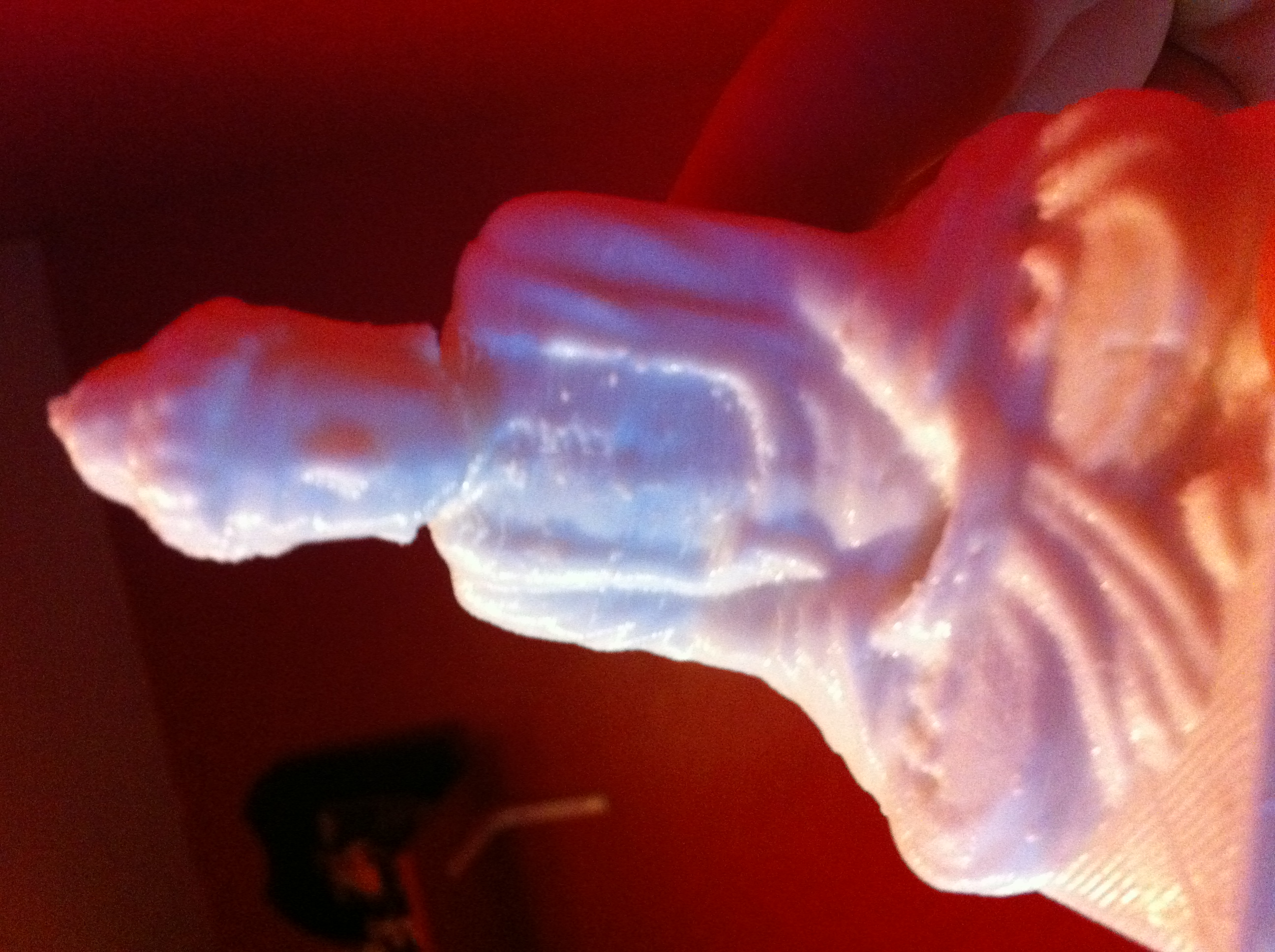

hi all,
I am having problems with support material, it seems to be eating into my print.
attached is a photo of this... you can see an example of this under the chin of the Buddha.
any help would be greatly appreciated.

I've found that increasing pillar resolution and using a few layers of dense layers helped to increase the resolution of the overhangs. Try 2.0mm for the pillar resolution and 2-3 dense layers (using the default Dense Infill Percentage).
