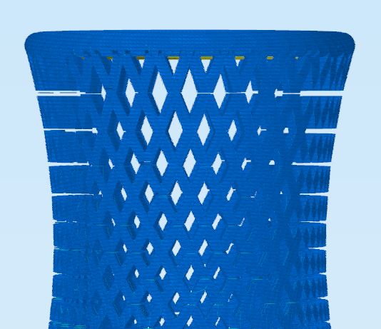

WOWIE! Thanks to your suggestions I got it to work! What I did was 2 things:
(1) Repair/Remove duplicate triangles
(2) Mesh/Separate connected surfaces
After that, slicing produced this, which looks 100% correct:

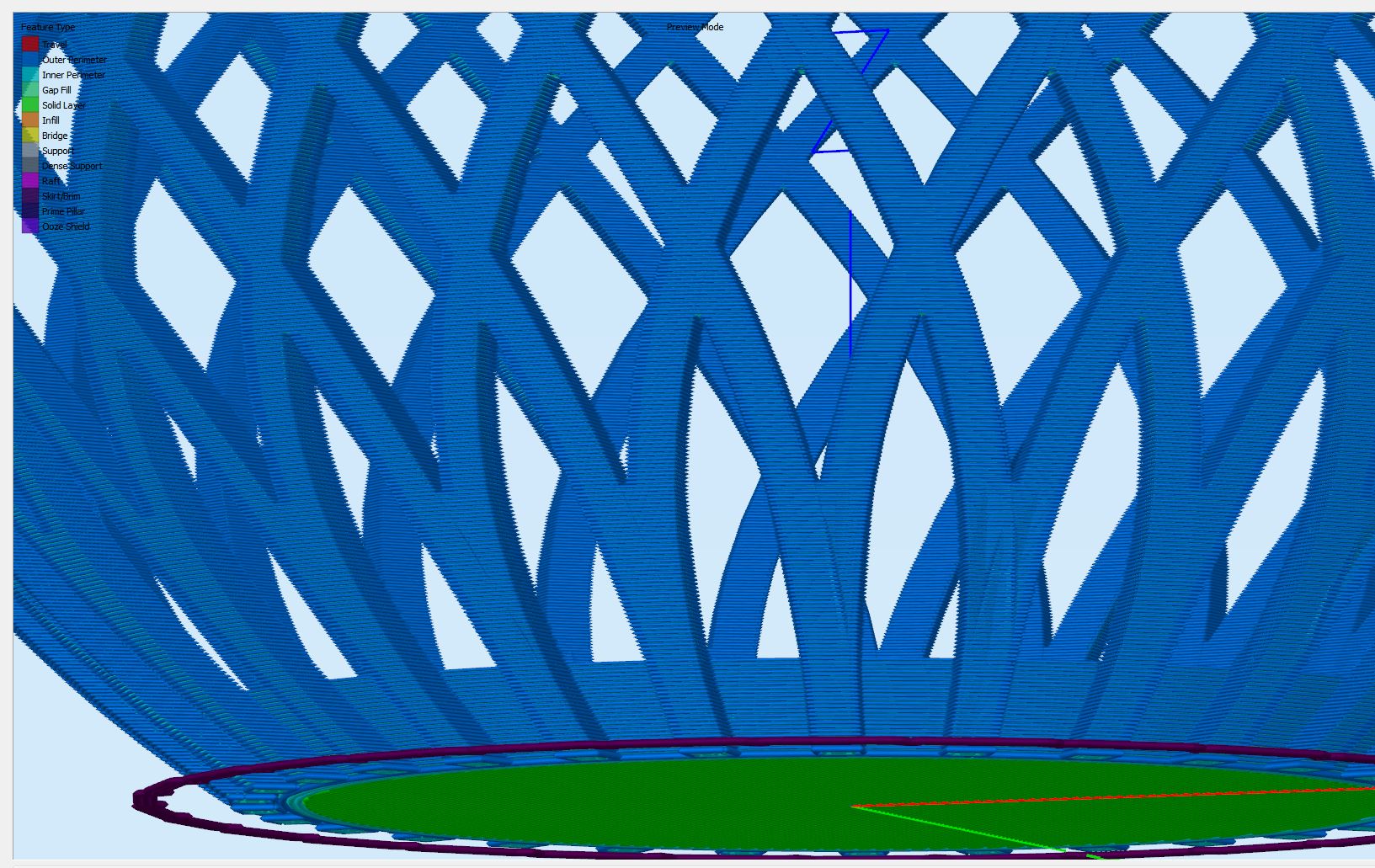

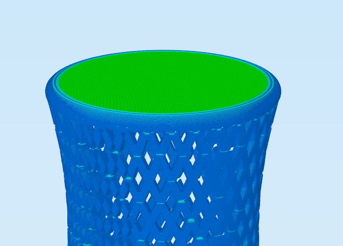

Many thanks for getting me on the right track. I've been going round & round with this for a while now. And in fact the situation is even more complex than this because I want to include the underlying surface on which the ribs are built. And, there are 2 of these surfaces - an inside and an outside. So that will be my next step - adding the underlying surfaces.
FYI the first thing I tried was just step (2) above. That produced a list of 32 items in the Models window. I wasn't sure what I was supposed to do with these, so I just sliced the whole thing. It was noticeably better - the missing diamond shapes where the ribs overlap were not missing - but there were still missing pieces and parts of layers at the bottom, where the ribs join the bottom piece.
So on a whim I added step (1) above and that did the trick. Apparently the combination of both is what has to happen to do a complete cleanup of duplicate triangles.
