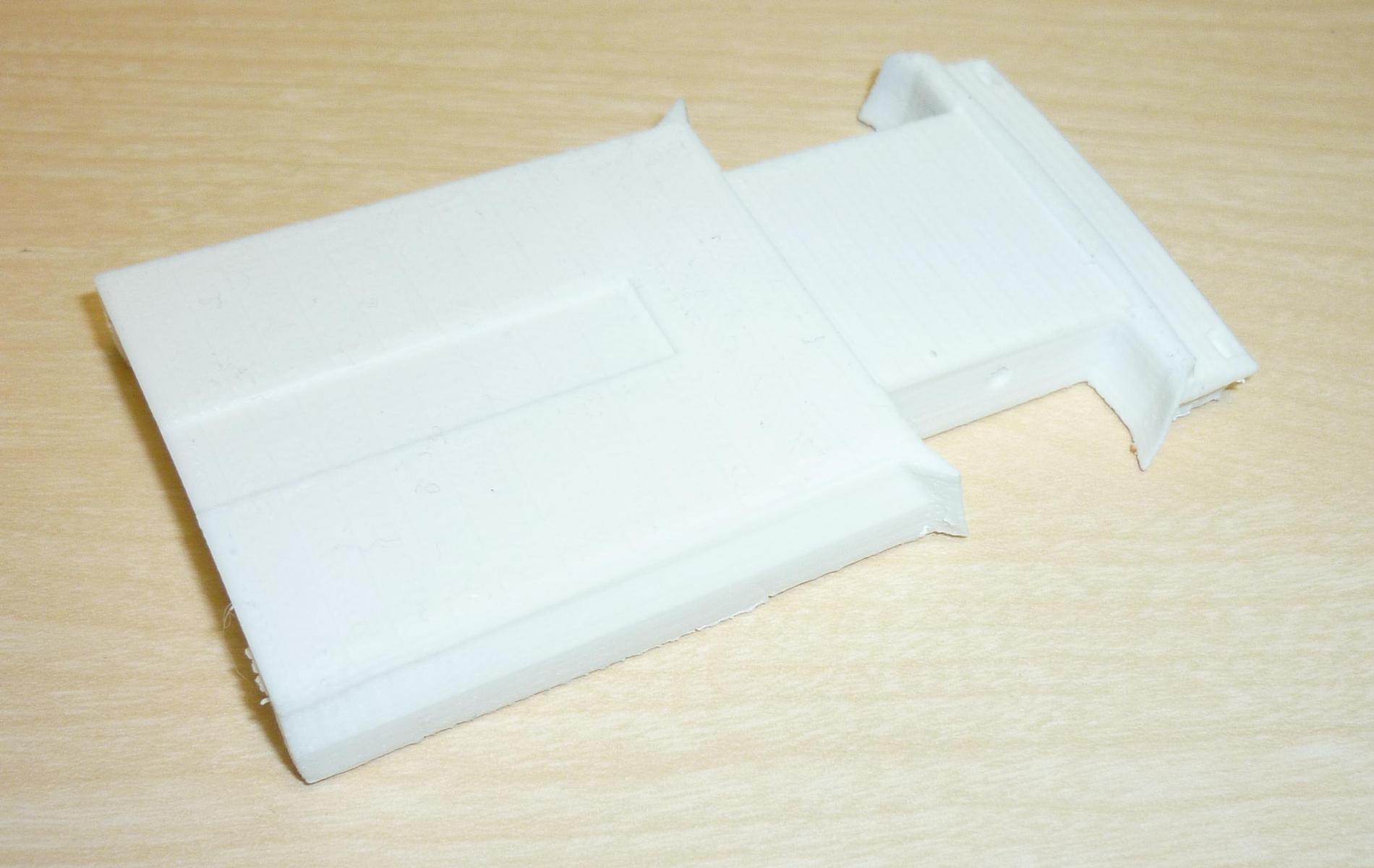

I’m trying to print the part shown in S3D 3.0.1, pictured on my standard 8-layer solid adhesion platform. Only the front end at the top of the image and the sides reach down almost to the adhesion platform. The back end is open, as is the entire underside.

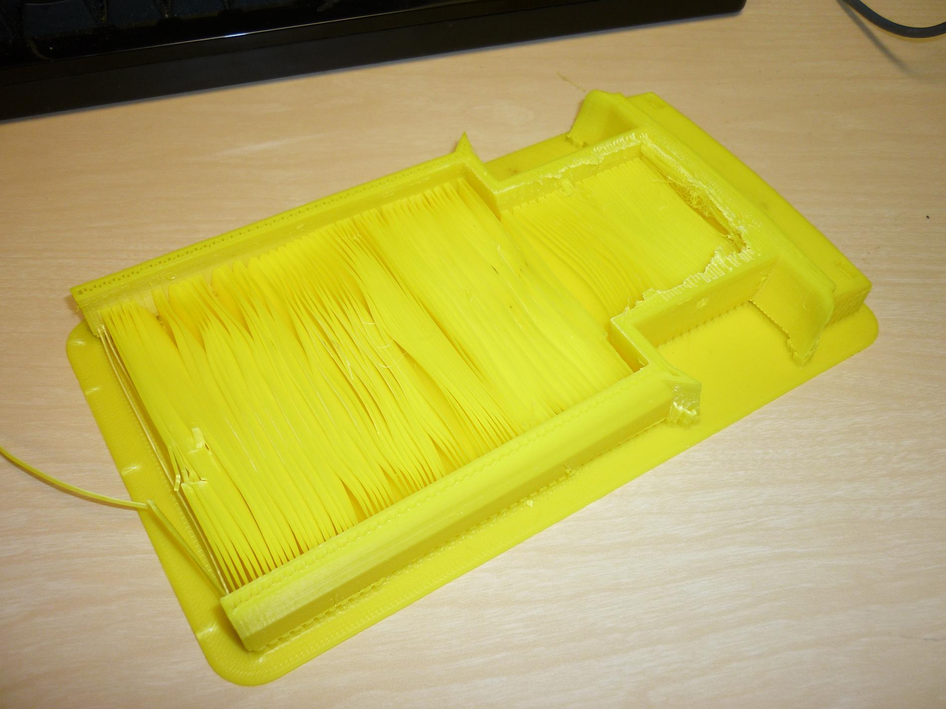

Using a 25% support fill with alternating 45 and -45 degree layers, this print fails reliably and repeatably the same way. At some hours into the print, noted on the second image as height “A”, support material stops printing entirely. Some time later noted at height “B”, the remaining layers of part geometry start to print offset in negative Y about 6 to 8 mm and the printing of support material resumes, leading of course to a hideous mess. This is what the part looks like after the mess is cleaned off it.
So if I change the support style to 0 degrees and 30% – which I had wanted to avoid because I know the sheets of support material will warp – and cut the scale by half, the part prints perfectly.
I tried to print this version at full scale, with 0 degree support webs, and the print failed again.
Interestingly, support material stopped printing at precisely the same place as when it was crosshatched. However, when support printing resumed, the remaining geometry did not displace.
