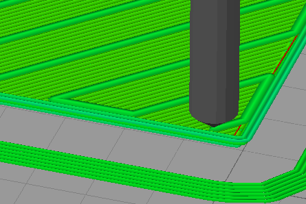

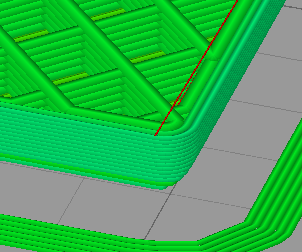

Here are the pics of the layers
Layer 2 and 3
Layer 2 and 3
Layer N+1
Layer N+1

Layer N
Layer N
layer N.PNG (43.59 KiB) Viewed 3344 times

Slicer Layer 2 and 3
Here is a picture of output from slic3r that shows layer 2 (solid layer) orthogonal (at right angles ) to layer 3 (inner layer at 25%)
