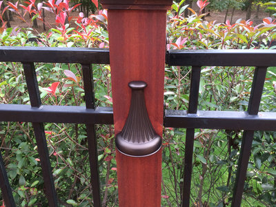

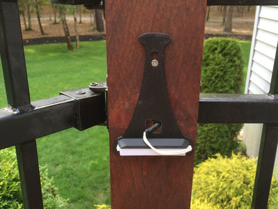

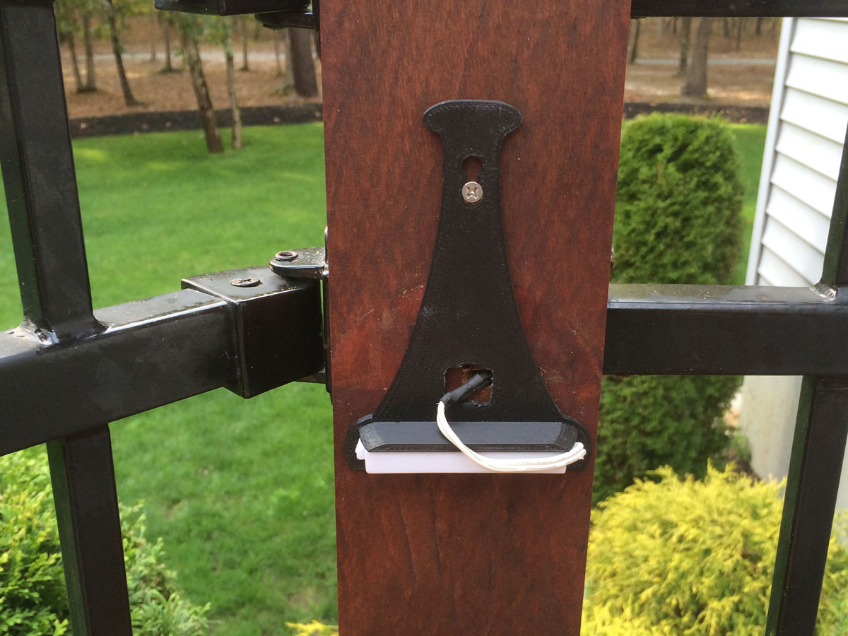

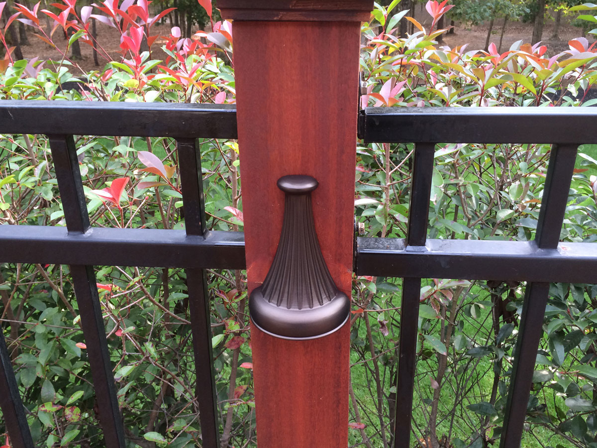

on another note, here are some pictures of that part i was printing. i had to do 14 of them plus 14 of the mounting brackets. these are the led post lights for my deck. i put them in my spray booth today, primed, sanded them smooth then did a dark bronze finish on them.the mounting bracket get screwed to the post and holds the led bar then the front cover snaps on.

Your parts look great! Yes, I have been printing abs at 190c. I know that sounds low, but I have been getting really good layer adhesion. I am going to slowly raise the temp and see how the results vary. I'm a little leary on setting it at 220. The last time I did that, I burned out a MG hot end.

Wow!
Your parts look great, I must say!
