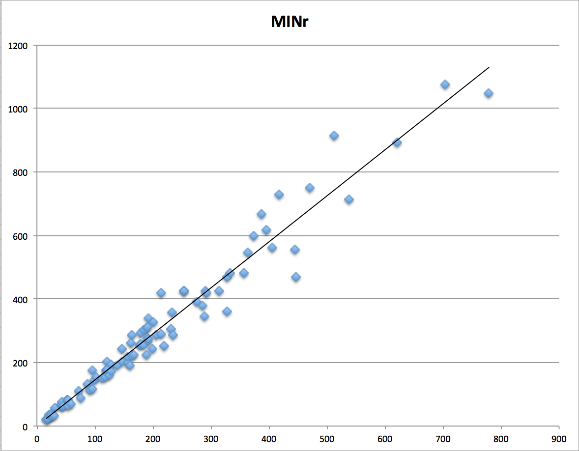

Many people have this problem, and it's been discussed in this forum several times. Try searching next time before starting a new thread.
The problem with time estimates is that in addition to being dependent on the complexity and size of the model you're printing, they are heavily dependent on some things S3D can't know about, like the acceleration and jerk settings in your firmware. S3D does a best guess, but will frequently be wrong. Myself, I logged the estimated and actual print time for about 100 prints I did ranging from a few minutes to over a dozen hours and came up with average error that I could apply for that particular printer. It's still frequently wrong, but it's closer than the S3D estimate.
