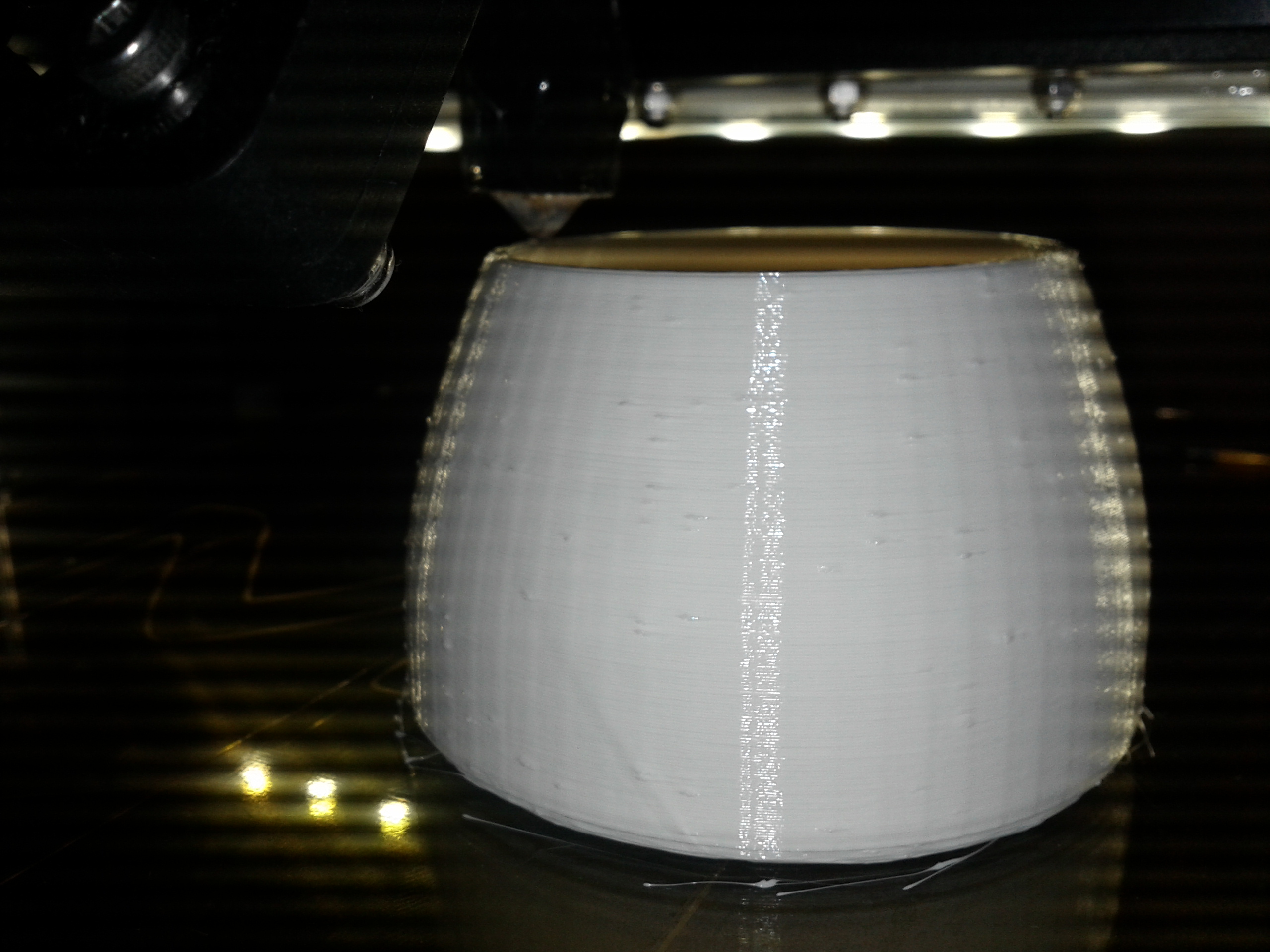

Curious which "retraction value" you guys are talking about?
In Creator 1.1.5, I see "Retraction Distance", "Extra Restart Distance", "Retraction Vertical Lift", and "Retraction Speed" all under the Retraction area. I am having problems with little dimples where the print head stops and starts, and thinking I need to adjust one of these settings?
