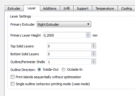

That´s not how you do it. You should build a single wall. The recommendation is to set your extrusion width no lower than 1,2 times your nozzle diameter.
If you wan´t good adhesion between the layers you have to squeeze down the filament a bit.
