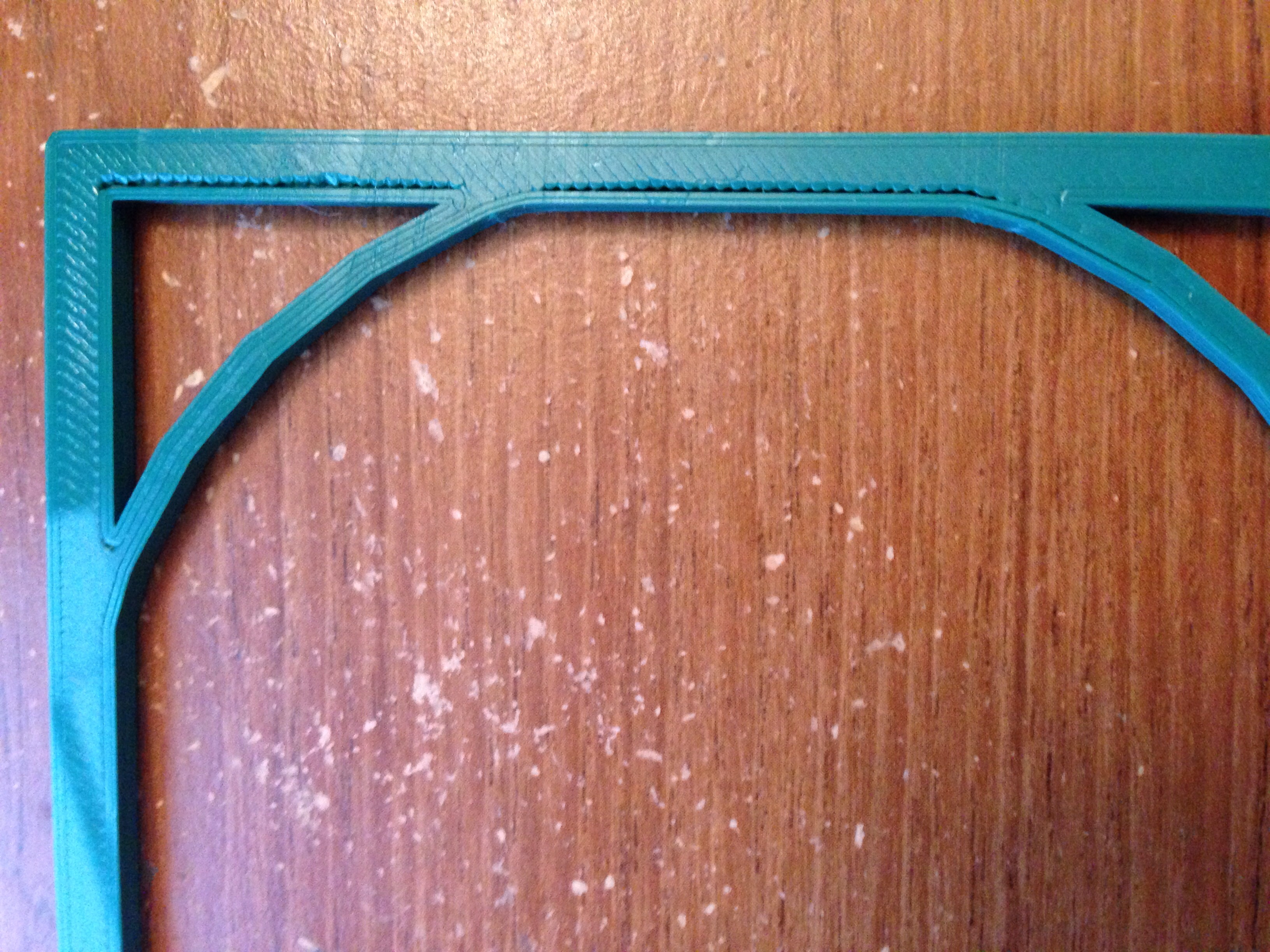

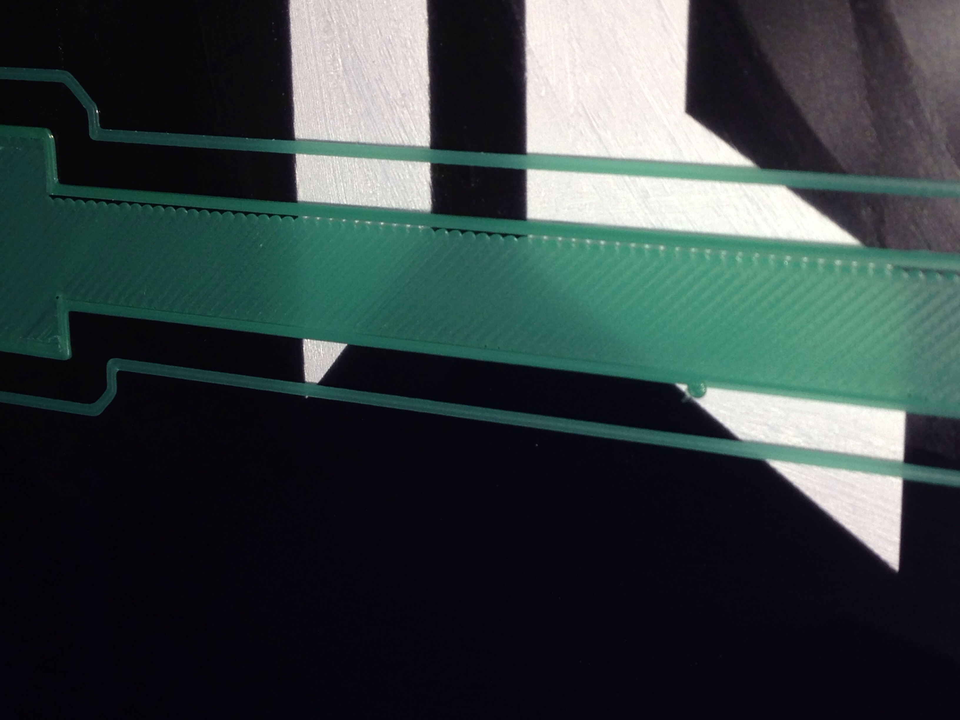

Recently made the switch to simplify3d and printed the recommended calibration Thingiverse object. It's not closing the left side of the bed on the x axis. I started the x and y calibration e steps test but it did the same thing. Can anyone tell me how to remedy this?
Re: Print not properly filling in along x axis
Go to Infill tab and increase the outline overlap setting by about 25%
